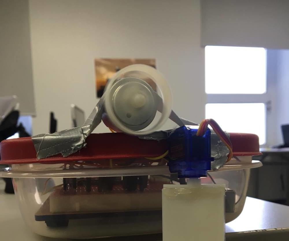

1) Installation of the servo Arduino circuit - The first of all things to do is actually to take care of all the electronics. Now in order to make the head of the parrot move, an Arduino circuit needs to be set-up for the servo. To do so, we need to plug every wires to their respective place on the breadboard. You can refer yourself to the image above or read the instruction manuel of the servo Arduino circuit for further information.
2) Coding of the Arduino (servo) - When the circuit is complete for the servo, a code needs to be entered in the Arduino (look bellow for the code). To do so, the code first needs to be copied in the Arduino software. After, we need to upload it on the Arduino itself using a wire (connecting the computer and the Arduino). We can then test it. It's supposed to go from right to left.
3) Installation of the Piezo Elements Arduino circuit - In order to make our parrot "sing" the tetris song, an Arduino circuit needs to be set-up for the piezo elements. This will act as a "speaker". To do so, plug every wires to their respective place on the breadboard. You can refer yourself to the image above or read the instruction manuel of the piezo elements Arduino circuit for further information.
4) Coding of the Piezo Arduino (Piezo Elements) - When the circuit is complete for the piezo elements, a code needs to be entered in the Arduino (look bellow for the code). To do so, just like for the servo, the code first needs to be copied in the Arduino software. After, we need to upload it on the Arduino itself using a wire (connecting the computer and the Arduino). We can then test it. The piezo elements should play a simple melody.

11) Gluing the end of the servo and the Parrot - Before we assemble everything, the end of the servo needs to be glued with the parrot head. Hot glue should be used and the end of the servo should be glued under the parrot, obviously.
12)Assembling the Arduinos and the box - The 2 Arduinos should be placed in the 3D printed box. In a case like ours, where the printer doesn't work, put the Arduinos in a styrofoam body. For the styrofoam, use scissors to cut the styrofoam. This is useful to create a hole for the servo's wire.
13) Gluing the tetris blocks images to the box - This step is very simple. We only need to cut and glue the tetris blocks everywhere on the box.
14) Taping the blank page to the styrofoam - This step is not really essentiel. A blank page is cut and taped to the styrofoam. This hides all the wires and the Arduinos. *This step is not needed if the 3D printed box was used.
15) Placing the wooden blocks - Now, almost everything is done. We only need to place the wooden blocks under the styrofoam so that the wires are not damaged by touching the ground (this is not needed if the 3D printed box is used).
16) Putting the cracker in the parrot's mouth - Finally, put the cracker in the mouth of the parrot (wether it's the 3D printed block or the 2D printed one)
The only thing left to do is to connect the batteries with the Arduinos (as a source of energy) and install the head of the parrot on the servo. The parrot should start to move his head and sing the tetris song.

In the process of building our 3D printed tetris parrot, we faced some problems. One of them was that at the beginning, we were supposed to print a body for our parrot. We then realized that the printer couldn’t print a body wide enough to accommodate two Arduinos. To fix this problem, we decided to design a box where we could enter two Arduinos. But another problem appeared. While printing the box, the printer broke. It was broken for several days, so instead of a 3D printed box we took a styrofoam box to represent the body of our parrot.
Another problem in the making of this project was that it took several tries to print the head of the parrot because the printer was lacking, once again. You can refer yourself to the pictures above to see our different attempts.
The last problem we had was that since the head of the parrot is so heavy, it didn't want to stay on the moving servo without falling. We had to unglue the end of the servo that was connected to the parrot and glue it back, but this time, closer to the center of mass.
