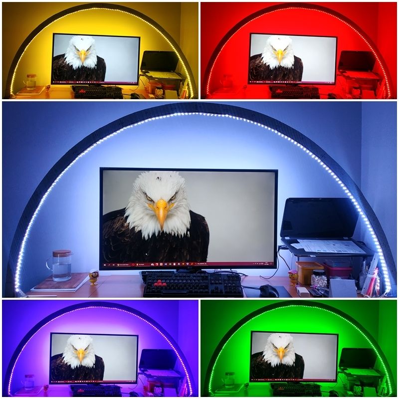

First, i started designing bridge lamp for my desktop dimensions.
My desktop length is 165cm. So the bridge lamp semi-circle diameter is 165cm.
It also provides circumference of semi circle is about 265cm and it suits 5mt rgb led for two lines.
I have and A4 laser printer and the template must be printable on A4 paper.
I divided semi circle to 11 parts for printing and numbered the joinings.
I share the templates below.

Step 5: RGB Led Strip Assembly
I cut the 5mt rgb led strip from the middle. As two cabled sides to be the same, i assembled to the 4 lined terminal. And i glued the terminal up of the clamp.
Step 6: Final Words...
I enjoyed to make this "instructable" very much.
You can wrap the construction with several materials for aesthetically pleasing.
But I prefer it looks as a cardboard.
It's simple and effective.
