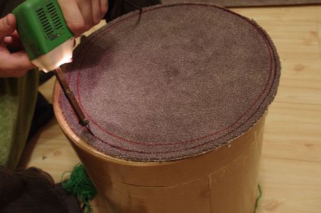

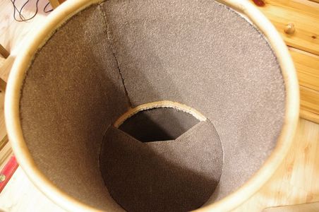

Step 2: Covering It Inside
Now let's cover those barrels inside. You need to cut the covering in right shapes with the utility knife and then stick them with glue using brush to the inside part of the barrels.
It's very arduous and boring step.
You should use soldering iron to heat edges of the covering.
3 of the barrels have "windows" and one of them is a dark room.
Every floor is connected from the top to the bottom.
IT IS A GOOD IDEA TO USE THE GLUE SOMEWHERE OUTSIDE

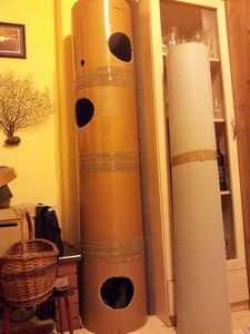

Step 3: Assembling It Together
You've done the hardest part.
Now you need to assemble those barrels together.
You can assemble them together using tape. Just tape it tight on the sides and it will be compact.

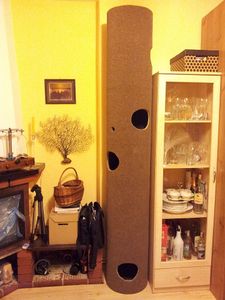

Step 4: Covering It Outside
Now you can cover the tower outside. Simply put the glue on the tower and wrap it with covering. After drying you can cut out covering on the windows.
Then leave it to ventilate for few days before using.

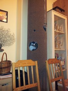

Step 5: Trying It Out With Your Cat
