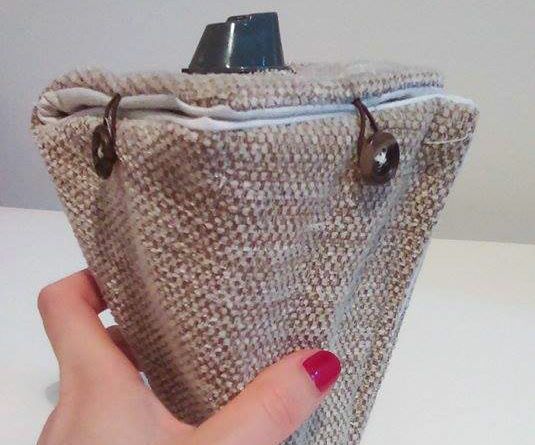

Introduction: The Chilling-Swing
The Chilling-Swing is usable outside and inside. In good weather you can drop him over a branch and enjoy the good weather, and in miserable weather you can hang him inside to read a book, watch television...
Another advantage. When the swing is dirty, you can easily remove the sitting and clean it in the washing machine. As good as new!
To make the Chilling-Swing, there are three parts: the sitting, the attachment and the storage-belt.
For start there's the sitting. Than the attachment. And thirdly the storage-belt.
In no time you have your personal Chilling-Swing!
Good luck and enjoy!
PS: In supplement you'll find a ppt-presentation with a user guide, from arriving in the park till leaving.
