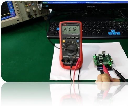

there are the features about the Massduino, help it can help you. The Massduino MD-328D support 3 kinds of analogRead mode, they are 10bits, 12bits and 16bits.
