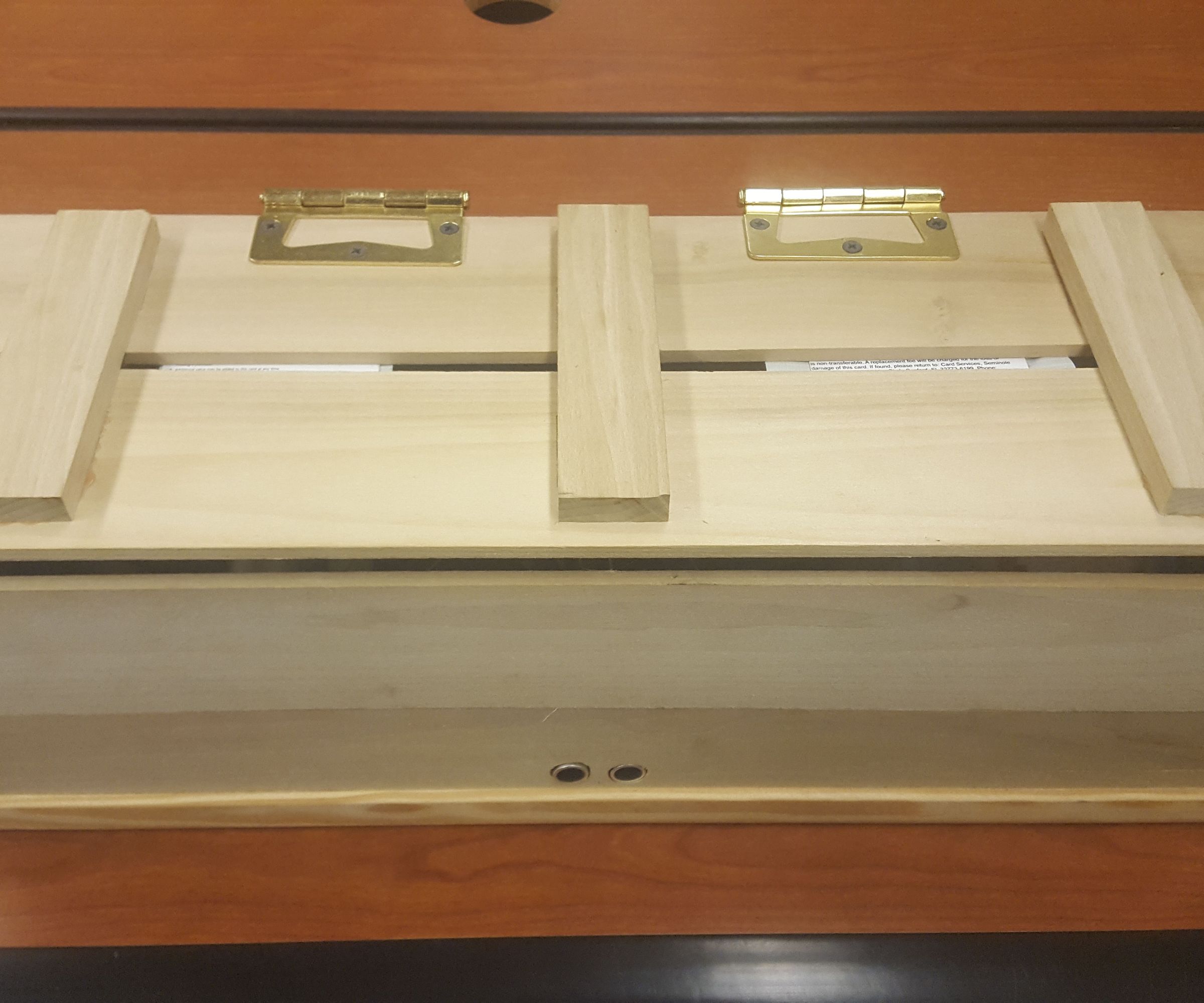

Step 3: Installing the Hinges and Adding the Fabric Covering
In this step we will install hinges to the spine of the completed top and bottom portions of the book, thus, completing construction on the skeleton of the Necronomicon. Following this we will adhere felt to the top/bottom covers and the spine of the book so that we can later add textures and give the book its terrifying features!
1.) Painting the Base Layer For the Pages of the Necronomicon
1a.) In this step we will simply paint the pages( textured faces) of the book white and allow this to dry. There is no need to be cautious during this stage because the felt will cover any mistakes made. A nice thin coat covering the entire are will be fine for this step.
2.) Installing the Hinges
2a.) This can be preformed while the white paint is drying. Take the two portions that you created in the previous section and place the top of the book on top of the bottom of the book. Make sure that the cover is on the outside and line up the spines so that they are flush. Also, line up the edges of the book. If constructed correctly you should have what looks like a book. At this point, with everything perfectly aligned, we are ready to install the hinges . Simply measure out one third and two thirds the distance of the total length of the spine and make a mark. This mark is where you will screw in the (3/4) " butt hinges. Once this is complete the top should now be connected to the bottom of the book and we are ready to move on to the next step.

Step 8: Adding the Inner Pages
In this step you will need 2 signs that you can procure from ACE Hardware or Lowes. These are nothing more than plastic at you will use to detail the back. You will need to paint these to mimic pages from the necronomicon. The best way to do this will be to pull up images from google and mimic what was done there. Once you have created the 2 pages necessary for the inside covers and allowed them to dry, you will want to add the high gloss sealer to the pages to keep them from future ware.
1.) Designing the Inner Pages
1a.) As previously stated, pull up the pictures on google and use these as a template. I recommend using a picture with a 'deadite' in it so that you can add the blinking LED in as the eyes. Stain the inner pages in the same manor as you did the exterior pages. Once this is done begin to trace the pictures that you wish on the inner page. Once this is done then you may begin to paint the area. Repeat this step for the second page. Once both of these are dry then you may apply the high gloss sealer. Let this try and then you are ready to cut in order to fit into the book.
2.) Cutting the Pages to Fit
2a.) Once the paint had dried you are ready to dimension and cut for the inner pictures. Here you will need to measure and account for movement of the lever system as well as the inner dimensions of the book. Once you have done this begin to trim the pages. You can use scissors to do this. It is easier to trim small amounts and measure multiple times. This will allow for minimal error when getting the sized correct. Note picture number 3; this will be the final product.
3.) Drill holes in the Eyes in Order to Insert the LEDS
Here you will need to put on your safety glasses and use the drill in order to make holes for the eyes on your deadite. Once this is done then you can adhere the red LEDs in place. Simply place the LEDs through the holes and adhere in place.
4.) Securing the Pages into Place
Once the previous steps are complete, you are ready to perform the last step. Simply screw the pages into place.
Where you have placed the L supports is where you will need to screw the pages in. Once this is done then your book will be complete. Now you simply be able to wave your hand in front of the proximity sensor are watch your book open and close!
