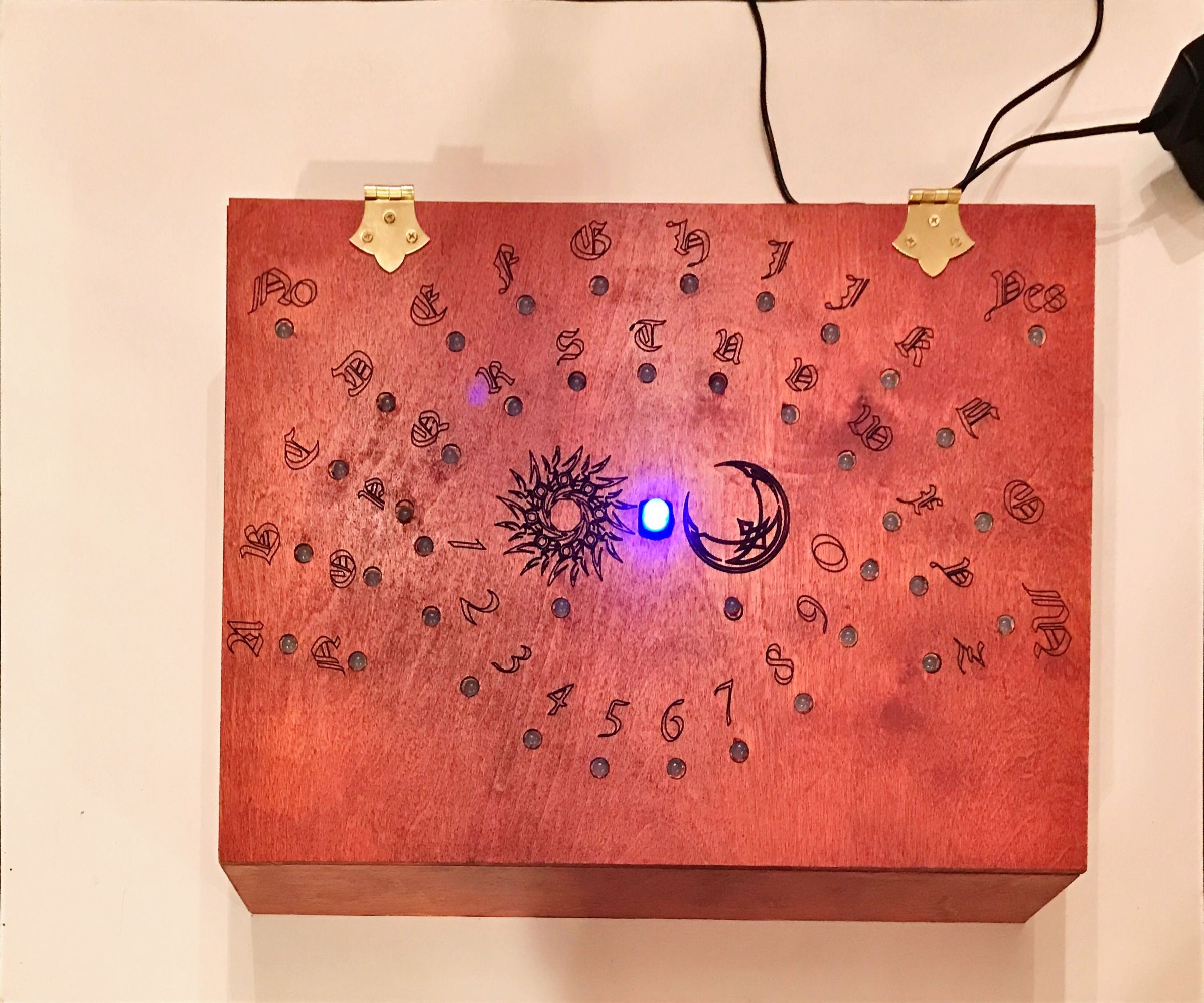

The portal is a piece of electronic art. The artistic idea was to represent particles of light being drawn into a rip in sub space or a "portal" that traverses from dimensional plain to another which can also be described as a wormhole. This contains two modes, the first being a standard standby animation of the lights flowing towards the "portal (represented in the video as two different versions of this animation). The second mode allows the lights to react to music being played changing its colors based on the music while it follows the standby animation of moving towards the "portal".
I am still working on the code for the lights to react to music. Right now that mode is represented as just the lights changing colors as they loop back to the beginning after reaching the "portal". I will update the video and provide a picture of it fully assembled after this is completed.

Write the code for the standers animation and for the lights to react to music.
Step 22:
Assemble everything together and you are done.
