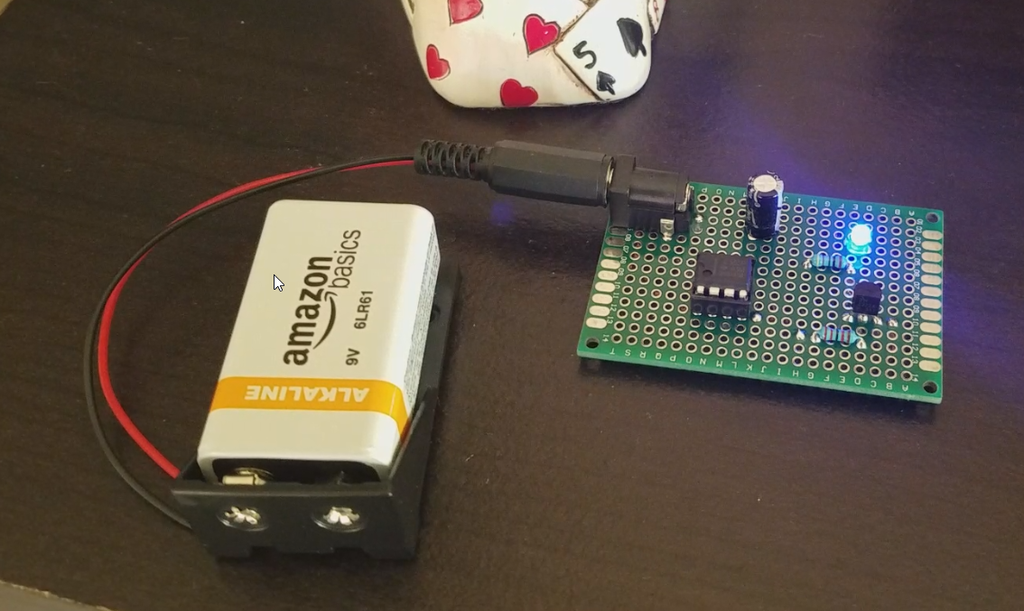

Step 2: Breadboard It
Break out the breadboard and proto it up.
555 Timer
Pin 1- To Ground
Pin 2- Jumper to Pin 6, Jumper to Base of NPN
Pin 3- 33k resistor to base of NPN
Pin 4- Jumper to Pin 8
Pin 5- NC
Pin 6-Jumper to Pin 2
Pin 7-NC
Pin 8-Jumper to Pin 4, Connected to Positive voltage
Emitter of NPN to 470ohm resistor to LED
Base of NPN to + side of cap, then ground - side
Collector of NPN to + voltage

The rest is easy. Place components making sure to keep polarity in mind. The top left pin with the circle next to it is pin one on the 555 timer. Both the capacitor and the LED have one long lead and one short lead. The long lead is the annode which is the positive side and the cathode is the shorter side.
Push the leads through the holes and bend them slightly on the other side to prevent them from falling out.
Solder away and power it up.
Wait... I forgot to add hole for power wires.
Actually I just forgot to drill them.
Hook up your 9v battery and apply positive to pin 8 and negative to pin 1. After a few seconds the LED should fade up, hold, and then fade back down. Lather, rinse, repeat.
