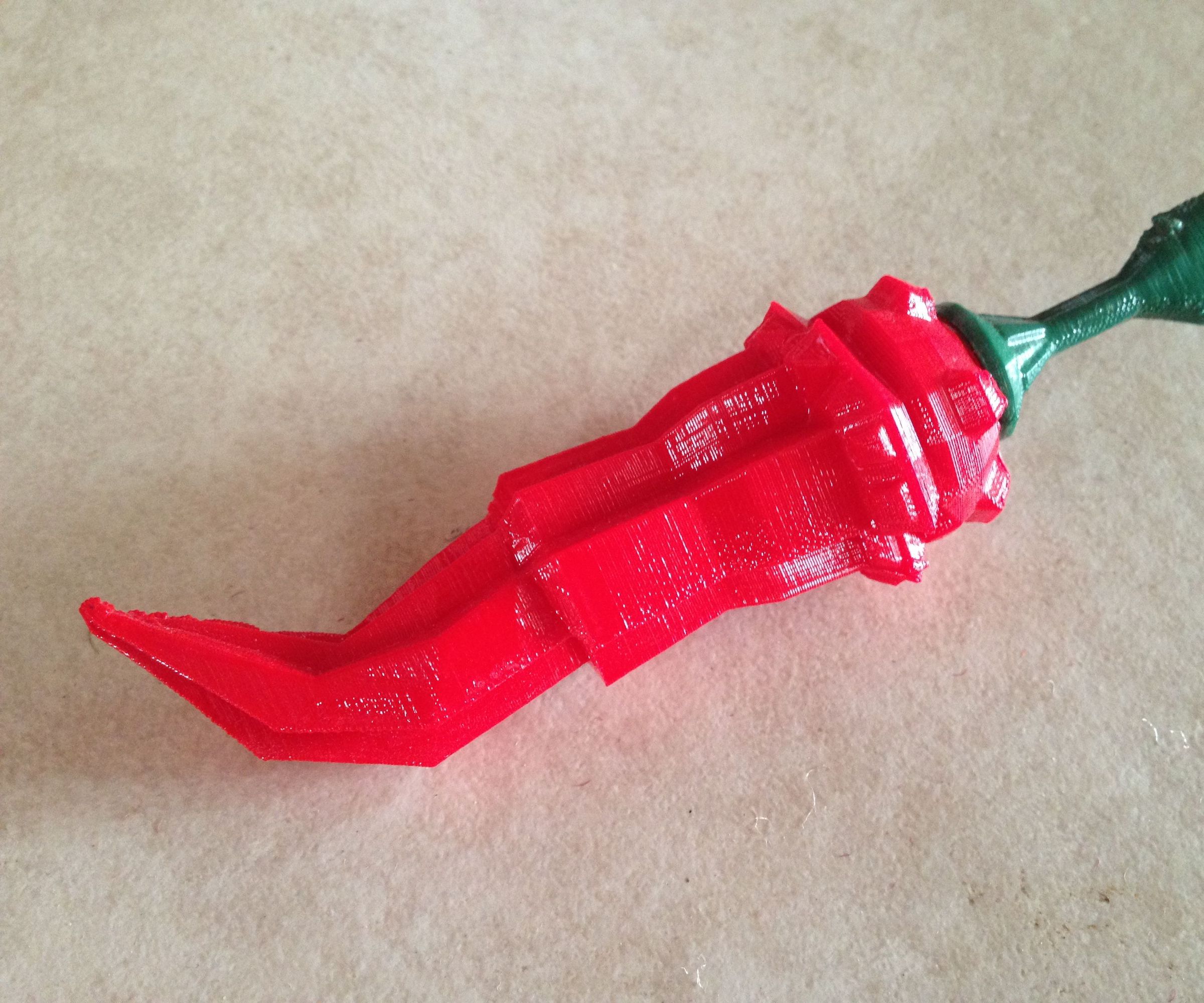

Step 1: Models
I have included two models (free of restriction, share with all of humanity). You can use either model, the claw model is of more utility and can apply greater force than than a natural nail. You can also generate your own models from scratch OR (the most realistic and best fitting) generate a 3D scanned model from a whole digit scan and applying a mirror function to the model.

Step 6: Print
PRINT. This prosthesis is most durable when printed in nylon. I suggest that one always use a human friendly plastic for anything contacting the skin. Taulman Nylon 645 is the best material that I found as it has superior strength and quality as well as meeting the EU's REACH standards for non toxicity. Currently there are no suitable FDA approved printing plastics, however that will soon change.
