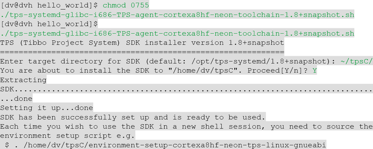

Step 2: LTPS SDK Installation
Full SDK image weighs around 0.5 Gb. It is not just a binary file; it is an installation script with an archive inside. Make it executable and run it to install the SDK.
Step 3: Setting Up the Environment
Run the environment setup script as advised by the installer.
