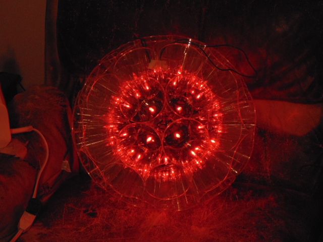

Start by cutting the 24" wide chicken wire down the center of a row of openings to a length of about 30". Bend the little wire extensions to the side so they can't hurt you. Easier to do this with gloves. This will allow you to continue to work without getting scratched by the sharp edges of the freshly cut wire (see photo). Fold the wire over on both ends equally twice. This adds stiffness.
Lay two of these lengths on top of each other so that you create an eight pointed star with all points extending out equally. This is the reason why you cut the lengths to end up not more than 25 inches in length.
Next, connect the two layers together using the 4 inch cable ties (zip ties) in the locations as shown in the photo to follow.
Step 5:
Lay out the chicken wire squares to create an eight pointed star with the welded fixture in the middle. Secure with wire ties at all the intersecting points. Line up the tines of the welded fixture to the intersection points of the star and secure in position with wire ties. Use an eight pointed star fixture as shown in the last step, not the six pointed star shown here.
Flip the wire assembly over to the other side. With your fingers, crease the wire at the locations about halfway up to the center starting at the points where you secured the wire ties so as to create a flower shape.
Next comes the lights. Here is what I used.
Step 6: The Lights
With a zip tie, secure the start of the lights in the location as shown in the photo above.
Following the lines created by the wire, stretch the wire over the humps and connect at the shallow insets of the flower.
Continue like this, connecting the wire bundle at the same inset locations. In the first revolution, you will have used up one third of your lights. When you get back to the start, secure the wraps of lights to maintain a 2-1/2" space as you connect the spiral upward. Here’s a link to a YouTube video that demonstrates what’s going on in this step.
