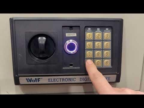

I found this old safe that died due to a leaking battery. It just needed some cleanup and re-soldering of the connectors to make it work again. There is a button inside that lets you reset the pin, so overall it was operational.
When I was about to place it somewhere for actual use, I started to think what would be a good pin code to use, one that I will remember for years to come and that isn't one of the "regular" pins we use at the house, so that my kids wouldn't be able to figure it out. That made me think about using an Authenticator-based time-based one-time passwords (TOTP).
Step 2: How the Safe Works
The way this safe (and I assume many other) work is using a large lock metal bar, that can slide in and out. Once out (locked), the spring on the edge of the solenoid jumps out and prevents the lock from going back in, hence the safe cannot be unlocked.
To unlock it again, you can either use the key (in the middle, not very visible in these photos), or if the solenoid will pull itself back. This of course happens when there is current running through it. The control board manages that part. It will fire the solenoid when the correct pin is entered.
The pin is entered using the keypad on the other side of the door. The green-ish ribbon is the connection between the keypad and the control board.

I connected everything on a prototype board, and drilled some holes to match the ones on the original board. This allowed me to use the same mounting screws that the original board had. I messed up the measurement a little, and it ended up a little croocked.
In the center, I placed headers for the D1 Mini. This gives plenty of space to connect the rest of the wires to the various pins.
On the top right I used a regular screw connector (POW) for power. This connects directly to the +/- from the power supply.
Below that I used the same connector that is used on the original board for connecting the solenoid (SOL). This wire gets the negative connection from the above power connector (POW), and the positive goes from the upper connector into the Relay's NO connection and back to the solenoid connector's positive connector.
The Relay module connects to the 5V and GND, and it's signal pin is connected to the D0 pin in the D1 Mini.
The buzzer is connected to GND and to the D7 pin in the D1 Mini.
Finally, the 7 pins of the Keypad are connected to D5, TX, RX and D1-D4.
