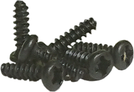

Some M1.7 Self taping screws.
- The majority are 6mm long, there is a couple 10mm long.

- I have made a Switch_Retainer.stl so that the switch can be held in place by two M1.7x10mm self tapping screws.

- Use four M1.7x6mm screws to hold it in place.

- Fix the OLED_Support.stl using two M1.7x6mm screws.
