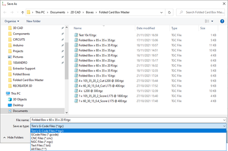

Step 4: Saving the G-Code File
There are two save buttons, "Save G-code To File And Close" and "Save G-code To File"
Make sure you have Generated G-Code before saving.
Save G-code To File And Close, Saves the G-Code to a File and closes the application.
Save G-code To File, Saves the G-Code to a File keeping the application open.
When the Save File Dialog window opens, it will give you a name for the file based on the settings used, you can change this to what ever you want.
Also the suffix will be set to ".tgc" (Tims GCode)
If you are going to use the file with different software you can change it.
Your choses are shown in the picture.
As I have mentioned, G-Code now comes in many flavours. The reason my files default to .tgc is because this file is my flavour of G-Code, which my plotter understands. Other machines may need some editing to the file produced, as mentioned earlier.

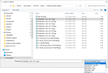

Using my application to send a G-Code file is fairly simple.
Coms, this is where you connect to your machine. Set the port and baud rate and click the "Connect" button.
Once connected click the "Open G-Code File" button. This will open a Open File Dialog window, choose the file created.
As mentioned before, my software defaults to ".tcg" you can change it.
With the Application connected and the file loaded, you will be able to click the "Plot G-Code File" button. This sends the file to the plotter.
