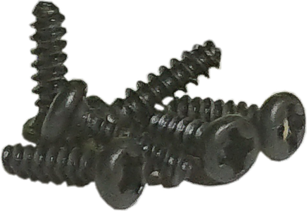

Screws
- I have used M1.7 x 6mm Self Tap Screws.
