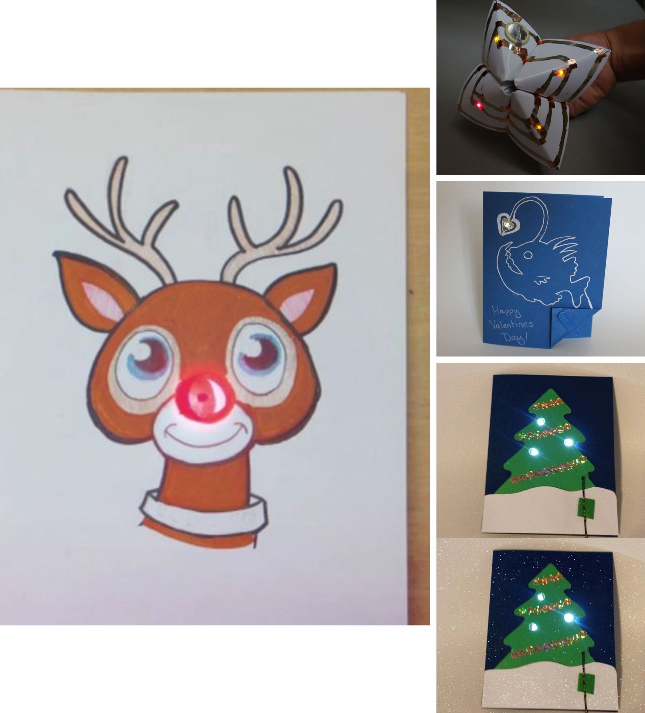

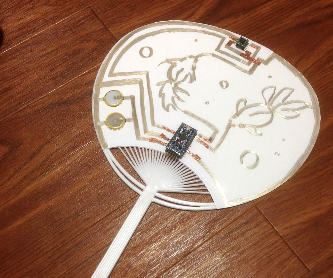

Introduction: Creating Switches With AgIC
Drawing circuits with AgIC marker is very simple, intuitive, and fun.
