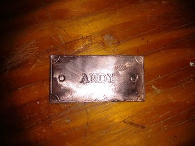

Step 10: Custom Hardware: Copper Name Plate
This is a brief explanation of how electrolytic etching works, if you want to try it, there are several instructables that explains better than me how to secure and successfully do it.
For more info about electrolytic etching: https://en.wikipedia.org/wiki/Electroetching
As a personal touch, the toolchest design includes a name plate with my nickname etched on it, it was made with a leftover copper sheet and started using a PC text editor and making a design in negative and mirror text, then the design was printed in magazine paper (it must be a toner printer), next the design was trimmed and transfered with heat (using a clothes iron) for about half an hour, after cooling the copper plate, the paper is removed washing the plate revealing the transfered toner.
If the design after the washing is not perfect, you can ''correct'' the missing toner spots with a permanent marker, nail polish and pieces of electrical tape, the idea is that the spots that are not protected whether with toner or any means will be corroded with the etching agent.
Once you have you corrected design, cover all the discovered copper areas (except the ones that you want to etch) with electrical tape leaving a copper section or a cable connected to the plate.
Fill a pickle jar with water at 90% of the jar capacity then add about 10% of salt and mix the solution, submerge you copper sheet in the brine (only the insulated and design areas, it must be out of the water the copper section that acts as a terminal) and submerge a steel wire in the other side of the jar.
Then use a direct voltage source and plug the negative terminal first to the steel wire, and the positive wire to the copper side, I used a 5 volts cellphone charger to do it.
Leave the electrolytic cell plugged for a couple of hours (5 hours in my case) and when you consider the etching is deep enough open the circuit and get the copper plate.
Wash and sand any toner or nail polish leftovers and polish with a wirebrush.

As a final part of the build there were glued the box corners on each end of the cabinet, it was used clear epoxy glue to avoid undesirable stains in the box paint job. The corners that are located over worktable face were modified to allow the worktable to be removed, it was just cut a little corner with the metal shears.
And finally, the name plate was drilled and installed at the front of the base cabinet with a pair of M3 screws, nuts and washers.
