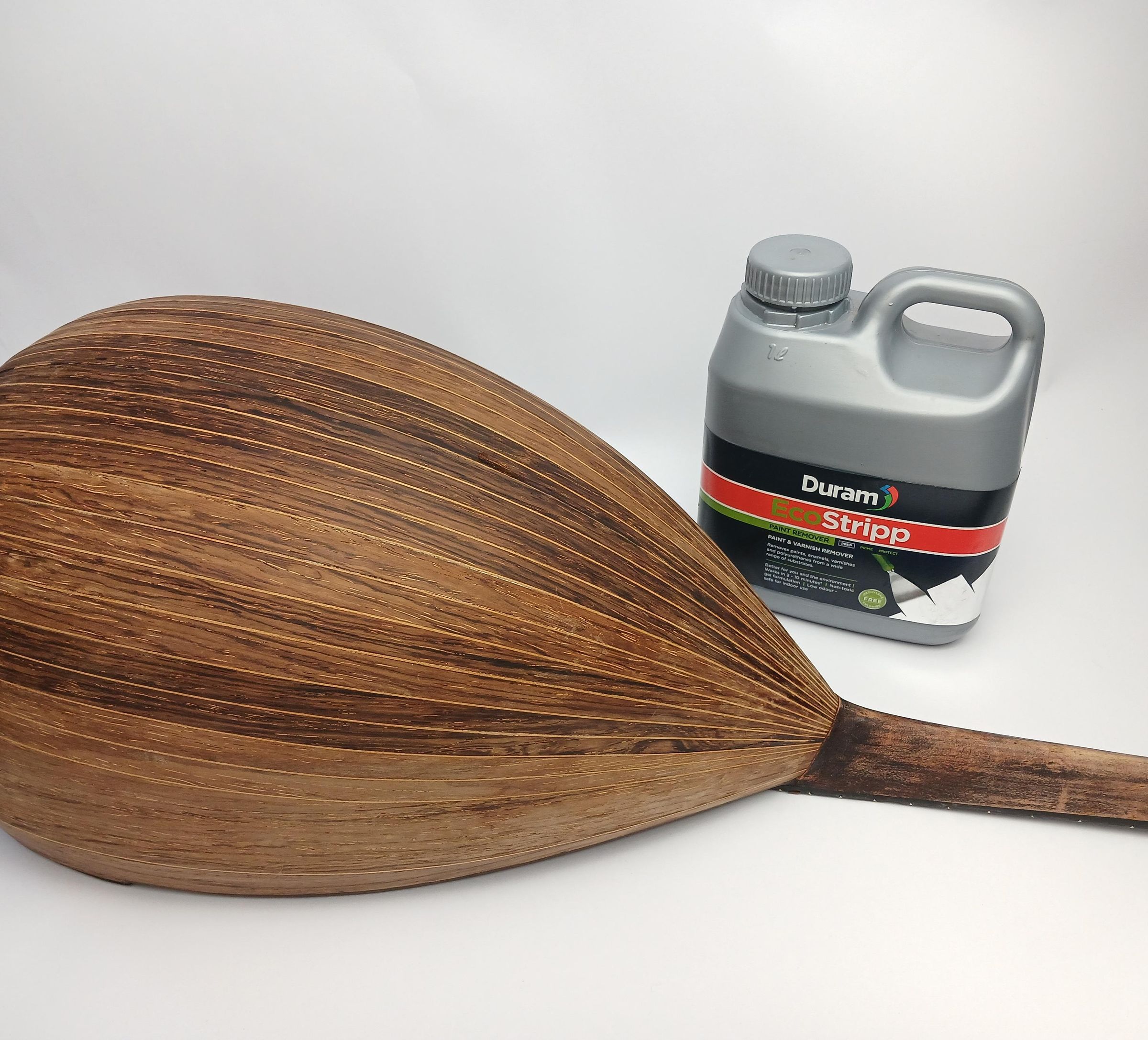

With the glue dry we can remove the tape and get rid of the old varnish.
For delicate projects like these I use an eco paint stripper that is very gentle and doesn't damage any of the decorative pieces or glue.
To remove the varnish I smear on a generous layer of stripper and then the mandolin in a layer of cling film for about two hours, afterwards you can scrape away the varnish with a plastic scraper or an old bank card.
Clean off any remaining paint stripper and leave to dry.
We are now left with a raw wood instrument that you can now sand with some 400 grit sanding paper to get rid of any blemishes and have a nice smooth surface for the clear lacquer later.

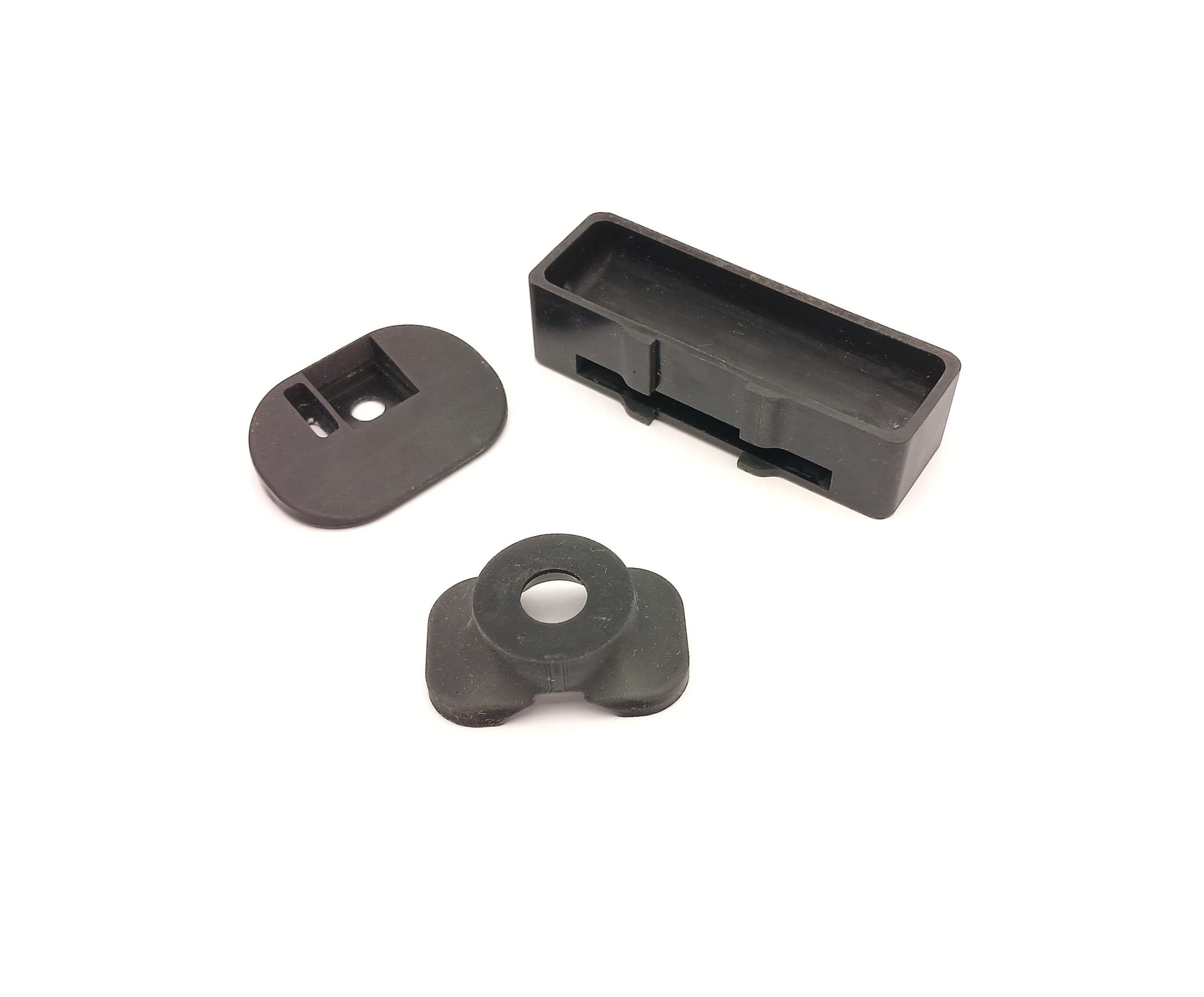

To house the electronic components I designed a battery/amplifier along with a switch/charging port holder using Fusion 360.
Because of wooden ribs placed underneath the bridge of the mandolin there wasn't enough space for the exciter so I had to also design a standoff for the driver to fit in between the ribs.
All the parts were printed using my Creality Halot One using black industrial blend resin but can be printed in any resin or with an FDM printer.
As the printed switch/charging port will be exposed I sanded it lightly with some 1500 grit sanding paper and polished it with some plastic polish to get a high gloss black finish that fits in perfectly with the rest of the black accents.

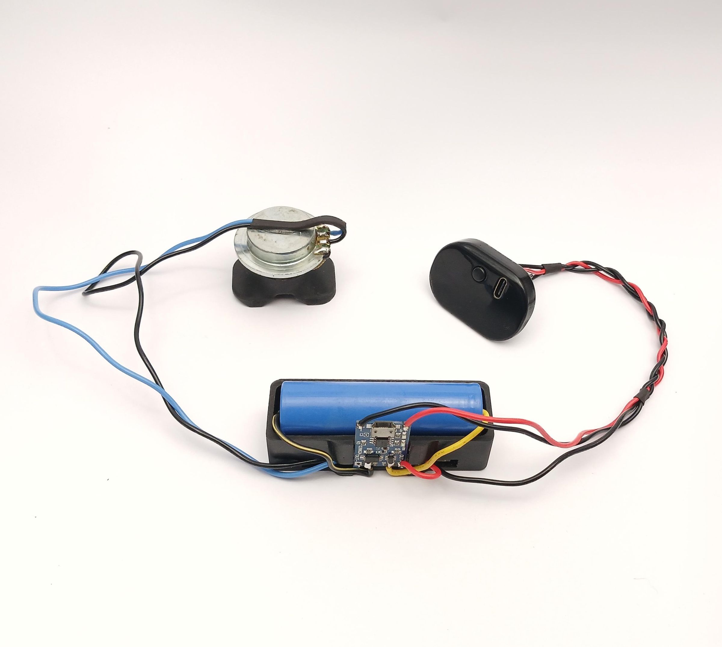

In this project I'm using a MH-M38 Bluetooth v5 amplifier powered by a rechargeable 18650 Li-ion battery, this drives a 38mm 10w exciter.
Wiring for this project is very straightforward, start by soldering on a wire from each pad of your exciter to the speaker positive (+) and negative (-) output on the amplifier then on your battery solder a wire from the top positive tab to the B+ on the charging board and a wire from the bottom negative of the battery to the B- pad on the board.
As I want the electronics as hidden as possible I had to attach a separate charging port to the board. I used a USB-C female power port and soldered the positive and negative wires onto the charging board as pictured. Finally solder a wire from the output + of the charging board to the positive input of the amplifier, the negative output - from the charging board goes to the switch and then to the negative input of the amplifier.
Once wired you can insert the components into the printed parts as pictured and you're ready to start assembling the instrument!

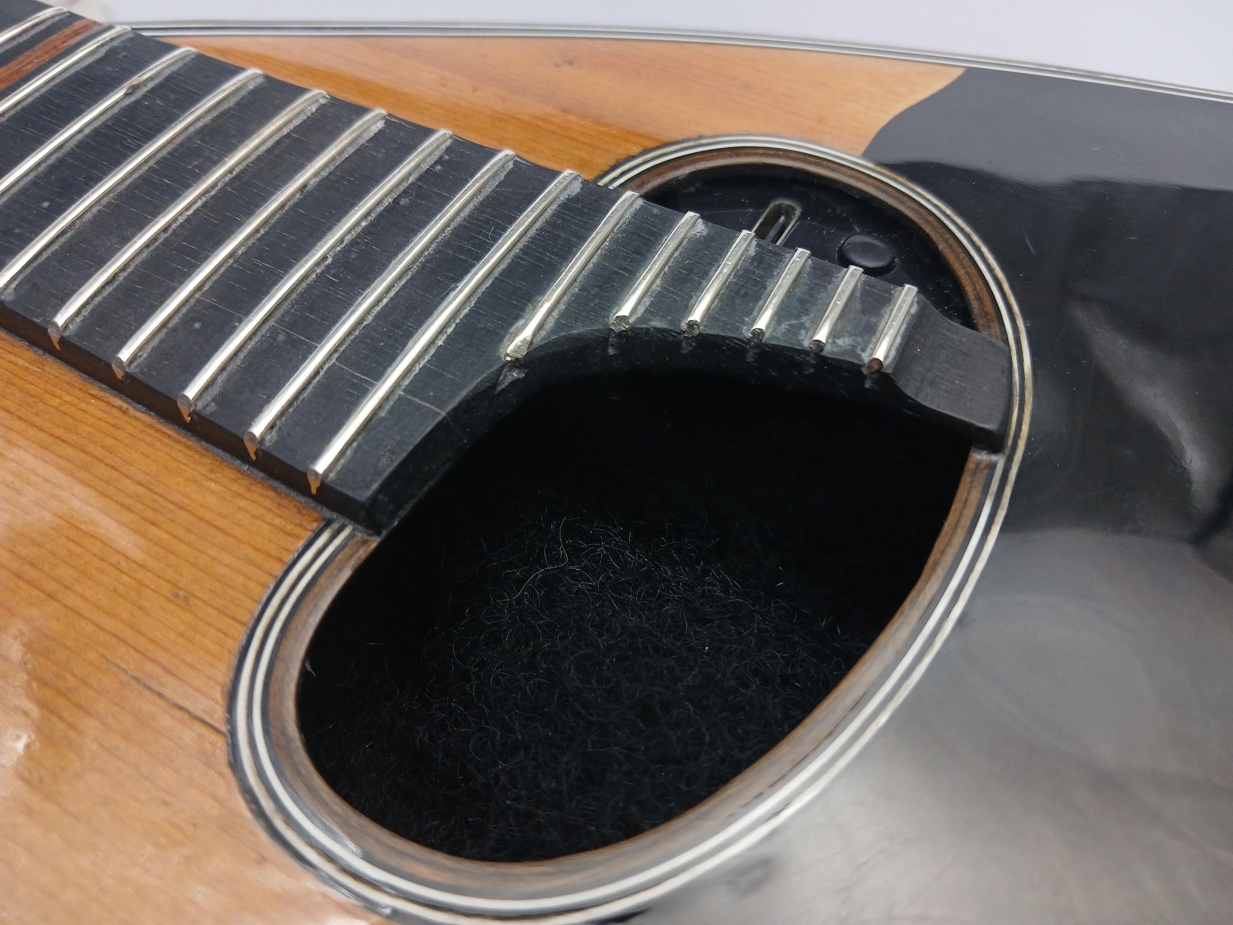

I started with getting the electronics mounted inside of the mandolin, unfortunately because the install space is so confined (literally just enough to fit two fingers at a time!) I'm unable to photograph but the battery holder/amplifier gets mounted with 2 part CA glue in front of the sound hole behind the start of the neck as far back as I could reach, this is to minimize the effect it will have on the sound.
Next the exciter was mounted in the middle bellow the bridge to mimic the vibrations from the strings. And finally I mounted the charging port and switch in the side of the sound hole so that just the port and switch are visible.
Upon testing on higher volume some of the back slats had some vibration so I decided to stuff some polyfill into the bowl that cured it. The last piece of polyfill was sprayed black to hide the internals.
