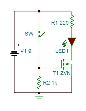

Step 2: A Simple Switch
MOSFETs are really easy to "saturate", which just means that they are fully open, and they are dead reliable for very fast switching between their saturation and cut-off regions (fully on and fully off regions). This makes them wonderful switches, especially for high power applications like motors, lamps, etc. In most cases, you can use the same power supply that you are using for your high power device to operate the MOSFET as well, using a mechanical switch to apply the gate voltage. The image below shows exactly that type of application. (Alternatively, you can also use an electronic signal, like from a microcontroller, to activate the MOSFET. This is extremely common, and useful, since the output pins on microcontrollers are not designed for high power applications. Also, be sure to check the gate threshold voltage for the MOSFET and compare it to the microcontroller output pin voltage. Some MOSFETs require more voltage than some microcontrollers can output.)
Build: Place the N-ch MOSFET on the board. Connect the 1kΩ resistor between the gate and GND. Connect the switch between the gate and +9V. Place the 220Ω resistor and LED in series between +9V and the drain. Tie the source pin directly to GND. See image below.
Push the button and the LED should light up. The 1kΩ resistor acts as a pull-down resistor, keeping the voltage at the gate at the same potential as the negative battery terminal until the button is pushed. This puts a positive voltage at the gate, opening the channel between the drain and source pins and allowing current to flow through the LED. Note that the gate voltage is +9V and there are no negative side effects.

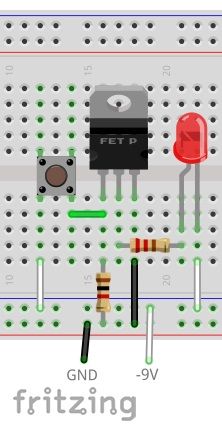

Now let's see how we connect a P-ch MOSFET. Remember that the relative positive/negative values for the gate, drain, and source are inverted here. See schematic below.
Build: Place the P-ch MOSFET on the board. Connect the 1kΩ resistor between GND and the gate. Place the switch between -9V and the gate. Place the 220Ω resistor and the LED in series between the drain and -9V. Connect the source directly to GND. See image below.
Allow me to digress for a moment because the connections here seem weird, I know. (If this already makes sense, just push the button.) Instead of using the positive side of a 9V battery as +9V, we are using it as GND and the negative as -9V. But remember, GND is arbitrary and relative, which can be really confusing. You get to set it where you want it so that it makes sense. So let's look again at what we are building.
Look again at image 3, the schematic. Remember that for a P-ch MOSFET, we need the source to have the highest relative value, the drain should have the lowest relative value, and the gate lower than the source, but greater than or equal to the drain. We know that the positive terminal on a 9V battery is 9V more positive than, or relative to, the negative terminal. By saying "more positive" we can start to get out of the +9V/GND box and start to think more relatively. We can also correctly say that the negative terminal is 9V more negative relative to the positive terminal. We can now give either terminal any value we want and the relation between the two stays the same. That's the important part. As long as the more negative terminal on the battery is connected to the pin that needs the more negative value (the drain), and the more positive terminal is connected to the pin that needs the more positive value (the source).
Anyway, back to the circuit. Push the button, the LED comes on again.

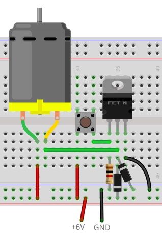

Step 3: Motor Drivers

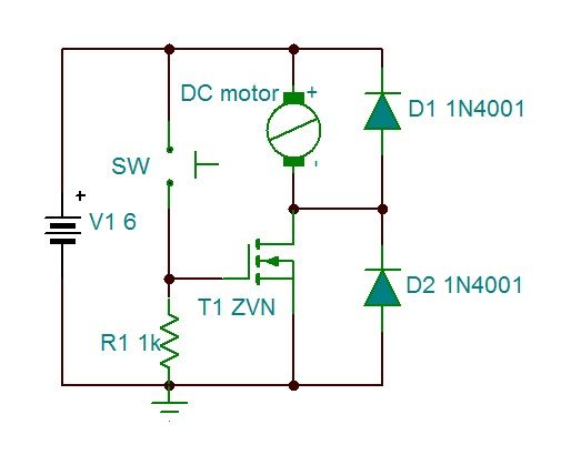

Building off of Step 1, we can use the ZVN as a DC motor driver. To avoid over-current damage to the ZVN, I'm using a small 6V DC hobby motor, much like the kind you find inside of small hobby servos. With a higher current N-ch MOSFET, you can drive larger motors with larger current needs.
Looking at the schematic below you'll see two diodes placed backward (reverse biased) across the motor contacts and across the MOSFET drain/source pins. Any electrical component that has a coil in it (inductors, relays, solenoids, motors, etc.) can generate a very large voltage spike in the reverse direction when it is turned off. (This is a common problem in airsoft, and it can lead to premature wear on the trigger contacts that turn on the motor. An easy fix for this is to add an "airsoft MOSFET", and this is a similar example. It should be noted that the parts used here are nowhere near capable of handling the voltage/current needs of an airsoft motor, so don't use this specific example.) The diodes give that spike a place to go so that the components are not damaged.
Build: Place the ZVN on the board. Connect the 1kΩ resistor between the gate and GND. Connect the switch between +6V and the gate. Connect the source to GND. Connect the drain to the negative motor lead. Tie the positive motor lead to +6V. Place one diode between the drain and source pins, with the stripe on the diode facing the drain pin. Put the other diode across the motor leads, with the stripe toward +6V. See image below.
Once everything is connected, double check it. And again. It's really easy to get things switched and even though it probably won't matter with this circuit, it's a good habit to already have when it does matter. Then push the button and your motor should run in one direction.

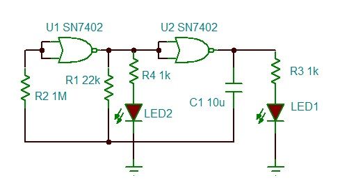

OK, let's begin with a simple LED flasher. Using just two NOR gates, we can build an oscillator. See schematic below.
LED2 and R4 are optional if you want to have two LEDs that flash back and forth. Otherwise LED1 will flash on/off at a rate determined by the values of R1 (try a potentiometer here) and C1.

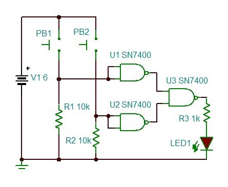

As mentioned before, any logic gate or circuit can be made from a finite number of NAND gates. Here's an example of an OR gate made with 3 NAND gates.
To change the OR to a NOR, add a fourth NAND between the output of U3 and the LED, with the two inputs of U4 tied together.

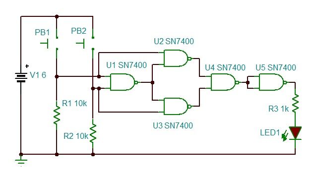

Anyway, back to it. Again using only NAND gates, we can build an XNOR gate.
By removing U5 and tying the output of U4 to R3, we get an XOR gate.

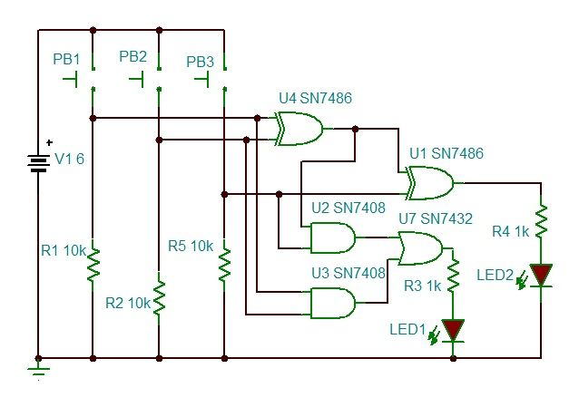

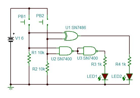

A single XOR gate can be used as a 1 bit binary adder. By adding two NAND gates (which is just an AND gate if you remember), we get a half-adder with a two bit output.
A full-adder requires a couple of changes (add an XOR, two NANDs, and an OR gate), which add an input to handle carry-in signals from a previous adder. Several adders are then stacked together, one adder for each bit, to build an adding machine. It's actually pretty elegant. Below is a full-adder circuit.
PB1 is bit A, PB2 is bit B and PB3 is the carry bit from the previous adder block. If we only press PB1 or PB2, we are adding 1+0 and only LED 2 will light to indicate a value of 1. If we press PB1 and PB2 together, that indicates a binary addition of 1+1, which is 10 in binary (indicated as 10b). That will light up LED1 and leave LED2 off. If we then press PB3 and add 1 more, we get 11b, and both LEDs light.
