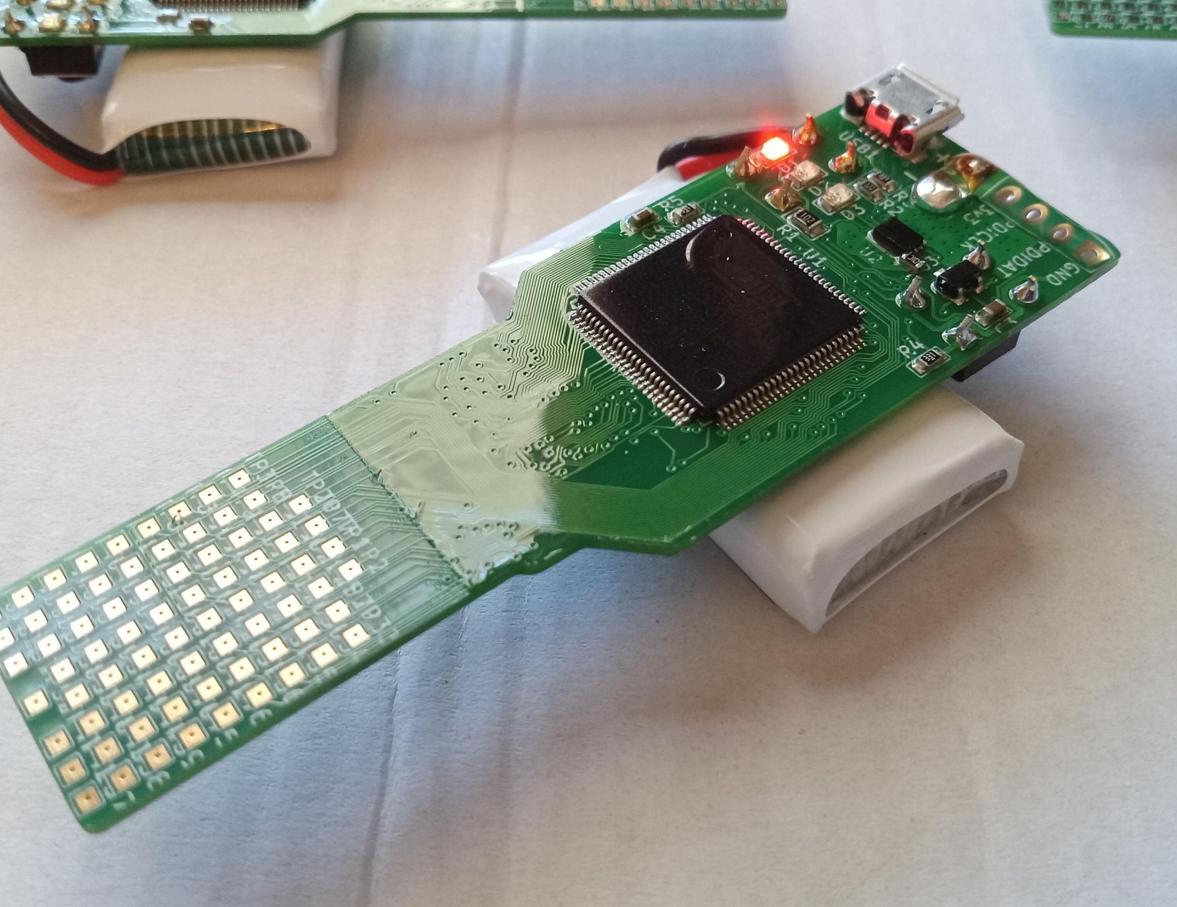

Step 3: Circuit Boards
I ordered circuit boards through Seeed Studio FusionPCB. The .zip files included in this step are the required gerber files. The driver boards can be made with Seeed's default settings, but the tongue electrode grid requires higher precision (5/5 mil clearance) and gold plating (ENIG -- though you could get hard gold instead if you want them to last longer, and if you've got an extra $200). I also got the tongue electrode grid fabricated with the thinnest circuit board option, 0.6mm, which makes it slightly flexible.
Because of the high cost of flexible polyimide circuit boards, we opted to use a rigid board for this prototype. Others reading these instructions who want to have this device fabricated on polyimide should bear in mind the required precision is 5mil traces / 5mil clearance, which Seeedstudio will not provide in flex PCB. You can -probably- get away with having it fabricated on the 6mil/6mil process Seeed uses for polyimide, but expect some of the boards to be defective, and examine / test each one. Also, a run of flexible polyimide boards costs about $320, last I checked.
After receiving the tongue electrode boards, you'll need to cut off the excess material. I used a dremel clone with an abrasive cut-off disc.
