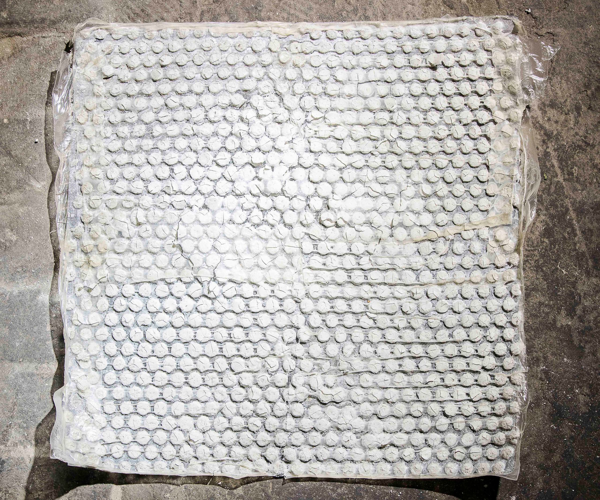

In this project two materials have been used and tested: a delta-3D-printer and a substance that is very similar to silicone. Unexpectedly its glass-like appearance is combined with a soft feel. The light blue dye reminds the viewer of water and has a similar “magnetic effect” like liquids naturally have. Sunlight intensifies the transparency as well as the brilliance and the watery shadow of the printed objects.

2. By using compressed air, the material will be extruded through the syringe. The pressure of air, the speed of motion of the arms of the 3D printer and the thickness of layers have to be adapted so that a fluent and continuous print develops.
