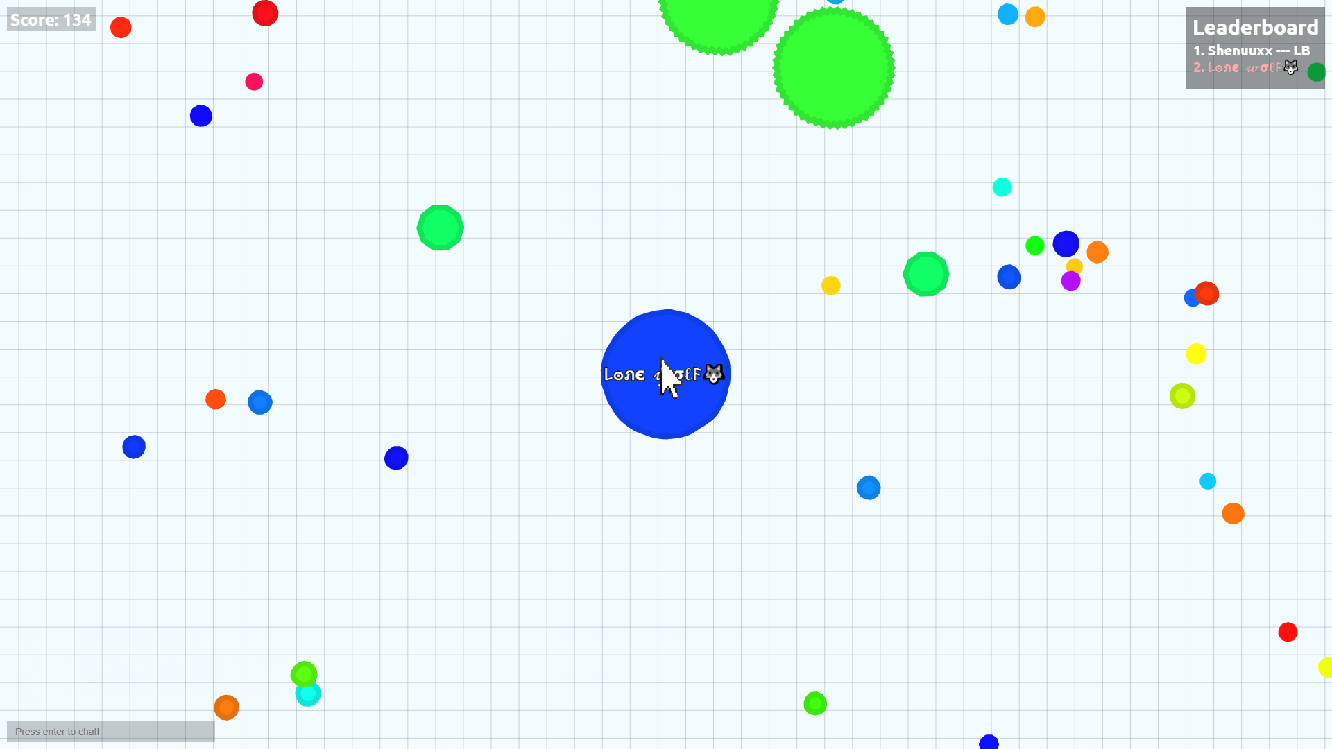

When playing games like Agar.io, slither.io, Cose.io, and other games that require a mouse to move the player around 360°, you feel like there's got to be an alternative to a gaming Mouse. In fact, you can lose accuracy, when you have extra space on your screen for your mouse to travel. It would be nice to keep the mouse in a small environment. And that's where the "hacked Wii nunchuck" comes into play. This project uses Arduino, AutoHotkey, and Nintendo.
Also since I am using a Wii nunchuck, I will take advantage of its accelerometer and other controls to make it work in Agario, Slitherio, Minecraft and as...A REGULAR MOUSE.
Here is a video of it in action showing all its features.
All these Controls can be found at the last step of this Instructable.
I will be using Cose.io for demonstration purposes.

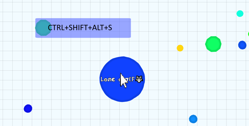

Before Hack
*I made the mouse a circle so it can be easier to see while gaming*
As you can see, the mouse travels across the screen in a mess, which is bad for accuracy in gaming.
After Hack
When we're done with this project, this is what the result will be...a perfect circle for the mouse cursor to be trapped in.

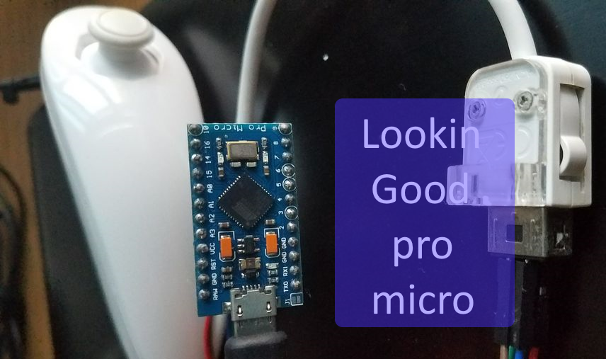

  1. Arduino Pro Micro(5V or 3.3V)

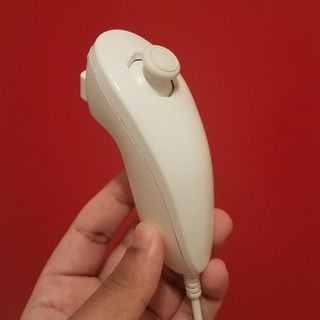

  2. A Wii Nunchuck
  3. Four Jumper wires
  4. A micro USB cable

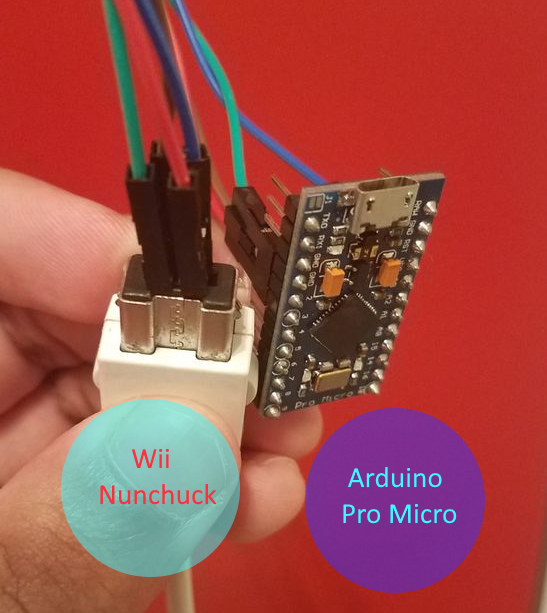

Step 2: Connect Nunchuck to Pro-Micro
Connections
Nunchuck ->Pro Micro
_________________________________________________
SDA(Data) -> Pin D2
SCL(Clock)-> Pin D3
VCC -> VCC
GND -> GND
I originally thought sticking the jumper wires into the socket of the nunchuck would be a bad idea...But turns out it's a simple and cheap way to getting the job done. But later on, I will be getting a wii nunchuck adapter from ebay, as the jumper wires will eventually break the sockets.

Step 6: Mouse Position and Combo
  • Next, place your mouse cursor at the exact center of the player.
  • You know you hit the center when the player stops moving. This part can be tedious so take your time. But when u get it, it'll be worth it. Unfortunately, there is no way for AutoHotKey to know the center of the player.
Run button in AutoHotKey
  • Finally, use The Macro combo as shown below.
Macro Combo: "CTRL+SHIFT+ALT+S"
To escape trap: "ESC"
Stop program: "CTRL+ESC"
I made the macro combo keystroke long because it is rare that any program in the world(other than this one) reacts to it. So there will be no mishap.
