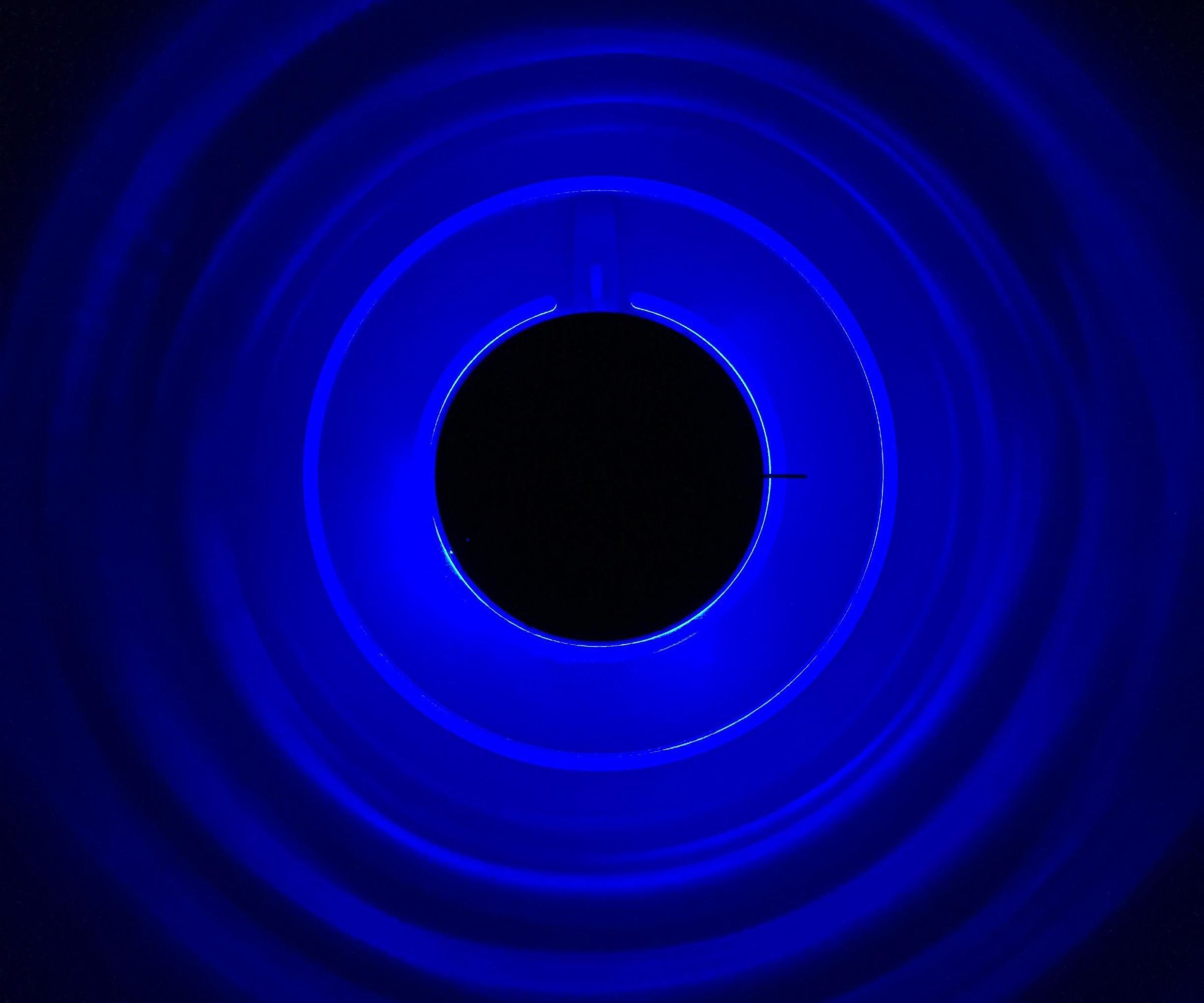

Once you have an LED tealight, take apart the cover so that the LED is exposed. With the tealight I used, I had to pry off the plastic flame as shown in the pictures. You can leave the cover on if you really want, and if it fits, but the light won’t be as bright.
Step 5: Finishing Touches
Next, turn on the tealight and insert it into the opening in the back of the assembled model. If your tealight has multiple lighting options, you can choose to have it cycle through the colors or leave it on a particular color. Now you’re ready to show off your identity disc!
