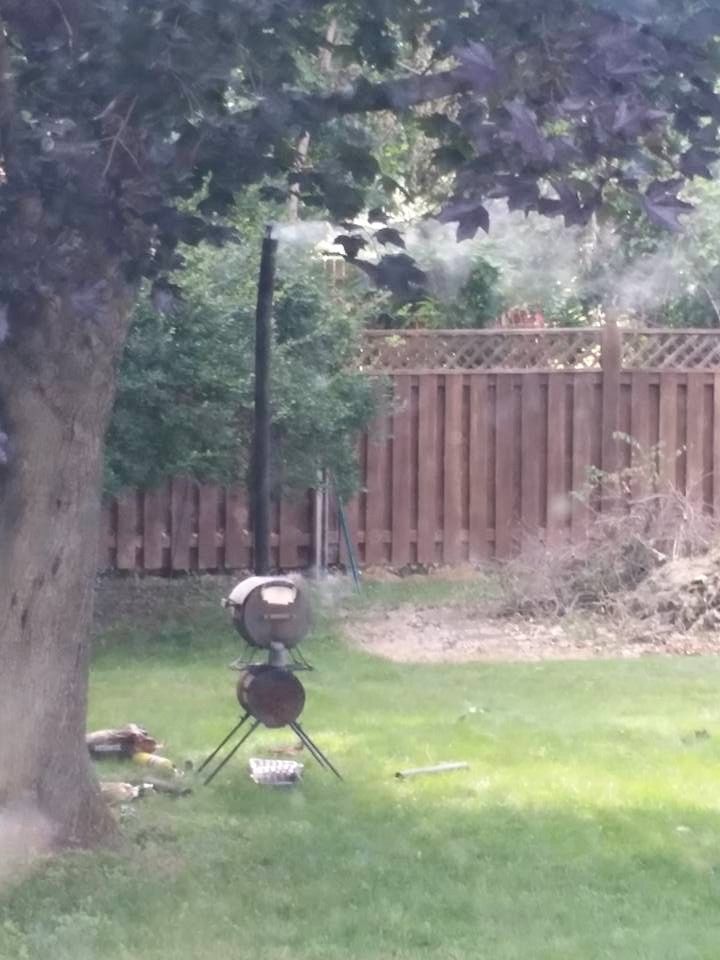

Then started welding! It took a couple of hours to go all the way around and get all the pieces together, but eventually I got the whole thing together. For the pin I just used a piece of threaded 3/8" rod and actually used the two bowls initially to hold it up. (later I built a frame for it by making a second circle with some square stock I had and just did a simple '+' shape with two arced pieces and put a second threaded hole down the middle as it made it easier to pull the whole unit off)
After all of the welding was complete, my initial test I had decided by then to instead try a high heat bearing instead of the balancing pin thinking it would be more stable. But the initial test was a complete flop as the bearing would quickly slow to a stop if I spun it and wouldn't spin at all above the fire. But I had already put a point on the threaded piece it was balanced upon and as mentioned earlier, I had already put the indentation in the cap to let the pin point rest into. So I whipped out the screwdriver, pulled out the bearing and tried just resting it on the pin to see what would happen. I had barely let go when it already started spinning around on it's own and I shot the attached video a few seconds later, I was so excited.
