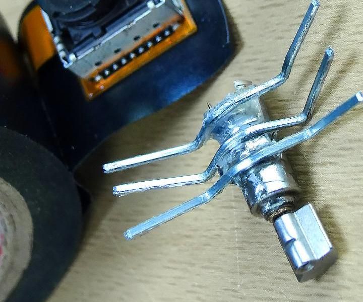

We'll take a few aluminum cans from any beverages. Sand with fine sandpaper or a sanding sponge.Pierce the can with a blade, then press down to split it into two parts.
Step 2:
Prepare the copper tube. It can be purchased at specialized stores for air conditioner or refrigerator repair and service. Find a suitable round part. Cut three pieces of copper tubing, each 10 cm long. Find a suitable round part. It could be a pipe with the right diameter or a dryer filter from a refrigerator, like mine. Bend it. The turbo stove can be made with three or two stripes. I chose the second option.
Step 3:
Mark the position of the tubes. Drill the center holes. Use a glass bead to find the center of the bottom. Drill the holes, enlarge them, insert the tubes, and then insulate them.
Step 4:
Pass the cotton thread through the tubes, then give one of the aluminum cans a shape so that one can fit into the other. After that, properly insulate both parts and remove any excess if needed.
Step 5:
Drill a hole on the side for the fitting and install it. Also, make several holes in the aluminum box, install the valve, and pass the high-pressure tubes through it.
Step 6:
Finish by connecting the hose to the compressor. Then you can conduct the first test, but don't forget to pour about 10 ml of liquid beforehand. With the help of the valve, we can easily adjust the desired flow and temperature by supplying more or less air. You can find a more detailed guide on my YouTube channel.
