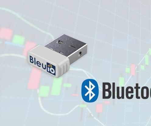

Step 1: ​Connect the Dongle
Connect the BleuIO dongle to your Raspberry Pi.
To identify which device name the dongle is connected to, you will need to run:
ls /dev
You might need to do it twice, once before you connect the dongle and once after to be able to identify which one is the device name. When starting up, the dongle will open up a COM port for the bootloader for 10 seconds to allow you to update the firmware (or flash your own application).
Afterwards it will close that port and open a new port for the BleuIO application which is the one we’re interested in here. You can run:
lsusb
