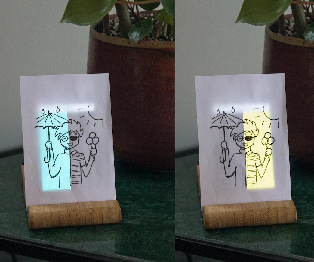

For this step, grab your phone, a piece of thin (or standard printing) paper and a pen or pencil.
What we like about smart displays is that they add something visually to the home. They can tell everyone in the home when something is happening, without a loud 'beep' from someone's phone. To make sure your smart display fits your home, skills and style, we will create our own! Instead of fiddling digitally, we are going to create a drawing, physically. If you are doing this tutorial with the family, try to get everyone to add something to it! Before we draw, we first need a holder for our phone.
Decide how to display your smart display
To make sure that your smart display can be seen from different places in the room, we need to make it stand vertically. This is entirely up to you and depends on where you want to have it. With permission of your parent or guardian, you could, for example, hang the phone on the wall with some hooks and wire, attach it to your fridge or perhaps place it in a phone stand. Either way, make sure the phone is plugged in and charging. If you don't have a phone stand, we found and followed a quick and easy tutorial on folding a phone stand out of an A4 sheet of paper by Wellington Oliveira (@Easy Origami) on Youtube. It takes no more than 10 minutes and fits nicely with the paper drawing in the next step.
Start drawing
At the end of this tutorial the phone will highlight areas of your drawing to indicate something happened, or in our case, when the temperature rises and when an email has been sent. Think about a drawing that could represent both of these things at the same time, or perhaps create two separate drawings on the same paper. The drawing doesn't have to be literal, it can also be abstract - anything you want really! Since the background highlights will be quite colourful, we suggest sticking to a line drawing with a pen or pencil. Don't worry about getting it right the first time, you can easily try a few drawing or change the drawing later!
  • Step 4.1 - Once you have found a stand or location for your phone,
  • Step 4.2 - Place a piece of white paper a bit larger than your phone, over the phone. Use thin, standard copier thickness (~70/80gsm) so that the phone's screen can shine through. Roughly mark the corners of the screen with some dots.
  • Step 4.3 - Take the paper off the phone, and start drawing! You can use the marked corners to know where the screen lights up later on.
  • Step 4.4 - Place it back in front of the phone, and press Clear Phone on the Home tab of your Google Sheet.
You can always come back and change or redo the drawing if you feel like it!

All that is left to do is to highlight your drawing when the data says something is happening. Using the Google Sheet, we will now indicate which areas should light up, and in which colours, using backgrounds. Let's first focus on the part of your drawing that indicates the high temperature.
Design two backgrounds
Once you have the Google Sheet in front of you:
  • Step 5.1 - Go to the [BG] 1 tab (on the bottom) and change the background colour of the cells/squares within the 'phone frame' that roughly corresponds with the part of your drawing that has something to do with the weather.
    • You can do this by selecting (click and drag) the cells/squares, and clicking on the fill colour tool: the little paint bucket in the toolbar.
    • The colour is totally up to you! You can even give different cells/squares different colours.
  • Step 5.2 - Click on the Test button to test the colours on your phone. Adjust the background and keep testing until you are satisfied.
  • Step 5.3 - Now, do the same for the email applet, on the [BG] 2 tab (on the bottom). Repeat the steps above but now focus on the parts of your drawing that have something to do with emails.
On the phone, if two or more backgrounds are shown, overlapping coloured cells/squares will mix their colours. If you don't want this, leave the cells/square black if you use them in another '[BG]' tab.
