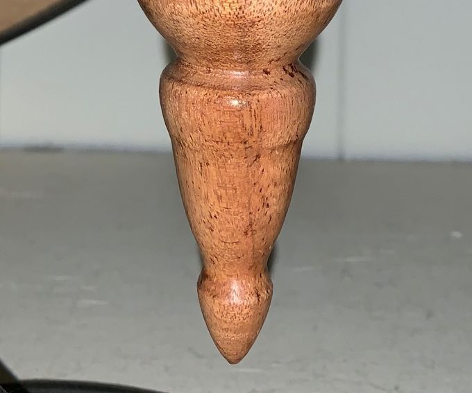

Your goal with the carving is to get the ends flush with the bushings so that the hardware will fit. One other tip I have is that if you get a knot or a chip in the wood (as seen above), put a dab of CA thin glue in the hole and fill it with shavings. Don't worry, you'll sand it down later.
You can carve whatever shape you want, just make it pen-like. For a true slimline, make the blanks uniform from end to end. Or you can go fancy and make the bottom half a little fatter around the middle and tapered down. You'll just want to make sure that on the top half you make it mostly the slimline shape as the pen clip will ultimately go there and it needs to be uniform for that.
