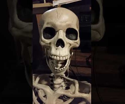

Step 13: The Raven – Vinnie (2017) - VOTE
More about the Poe short story than the 1963 Vincent Price film, this is a full size skeleton who, in Vincent Price’s voice, reads the Raven aloud. This is not your $15 talking skull from a discount store. All home built, it processes sound files live and programmatically determines the jaw movements. Currently its being expanded and modified to work with more skulls and live radio broadcasts. See the full Instructable
