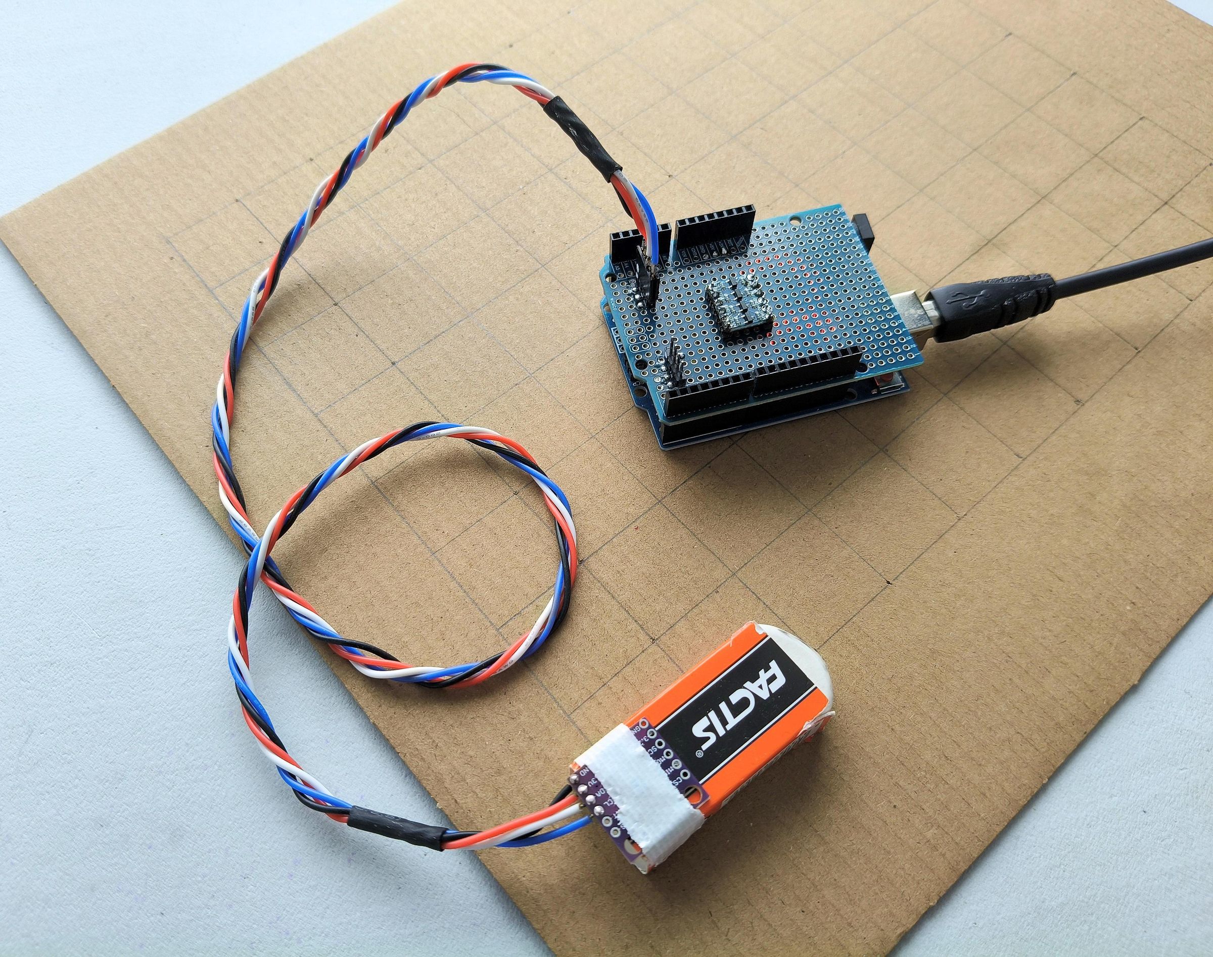

Step 2: Wiring Diagram
Only four wires are required to complete this project.
The wiring diagram is shown in photo1.

The HC-SR04 ultrasonic range-finder module (photo 1) provides non-contact measurements in the range 2cm – 400cm. The accuracy is typically +/- 3mm depending on distance, air temperature, and humidity.
