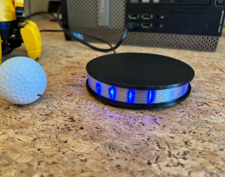

This project shows how to create an under-glow LED light for any moving vehicle e.g cars, RC cars, bikes, skateboards or as in my case, a scooter. It is based on using an MPU-6050 accelerometer sensor together with ATTINY85. I have tried to keep the design small, cheap and power efficient. The system changes LED color depending of the movement of the vehicle. I have selected green if driving faster (acceleration), red if breaking (deceleration) and blue if at constant speed or standing still. Color set and movement criteria can be changed by altering the code.
When not used it goes into standby after a period of time to save power and can therefore last in standby for several days before charging is needed.

Step 1: Assembly
These are the pictures of the different steps of the assembly.
Additional notes
In the block schematics it shows a flatpack LiPo battery which is not correct, its has been replaced and I now use a 18650 battery.
The block schematics only shows 1x pixel LED. I use 2x2 but the wiring is identical.
There is a patch on the battery shield between pin2 on the TP5410 LiPo charge circuit and D1 (marked yellow). The reason for this is to route this signal to the ATTINY85 to indicate on Neopixel the charging status. This is very handy knowing when the charging is complete. It drove me crazy not knowing when charging was completed (I find it strange this is not standard on the shield when A0 analog battery level exist).
The system uses ATTINY85 sleep mode using watchdog (see Software & Programming section) this to reduce battery consumption. When LED is lit in one color it consumes >100mA@3V7. In standby now it uses < 10mA@3V7. With a battery of 2000mA the system can then theoretically be in standby for ~ 200h or more than 8 days.
Encapsulation has been tested throughout the winter and it is working good. No indication of water ingress.
