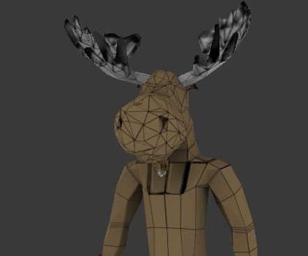

Since we've already made a character, please check our other tutorial (Making a 3D Model for Animation in Blender) over here: https://www.instructables.com/id/Pissed-Off-Moose-M...
For those who are lazy, feel free to use the character we made by downloading the "pissedoffmoose.obj"
*Notice* Due to time constraints, we didn't manage to animate the character. We used a ball as the player and made the moose a stage prop
