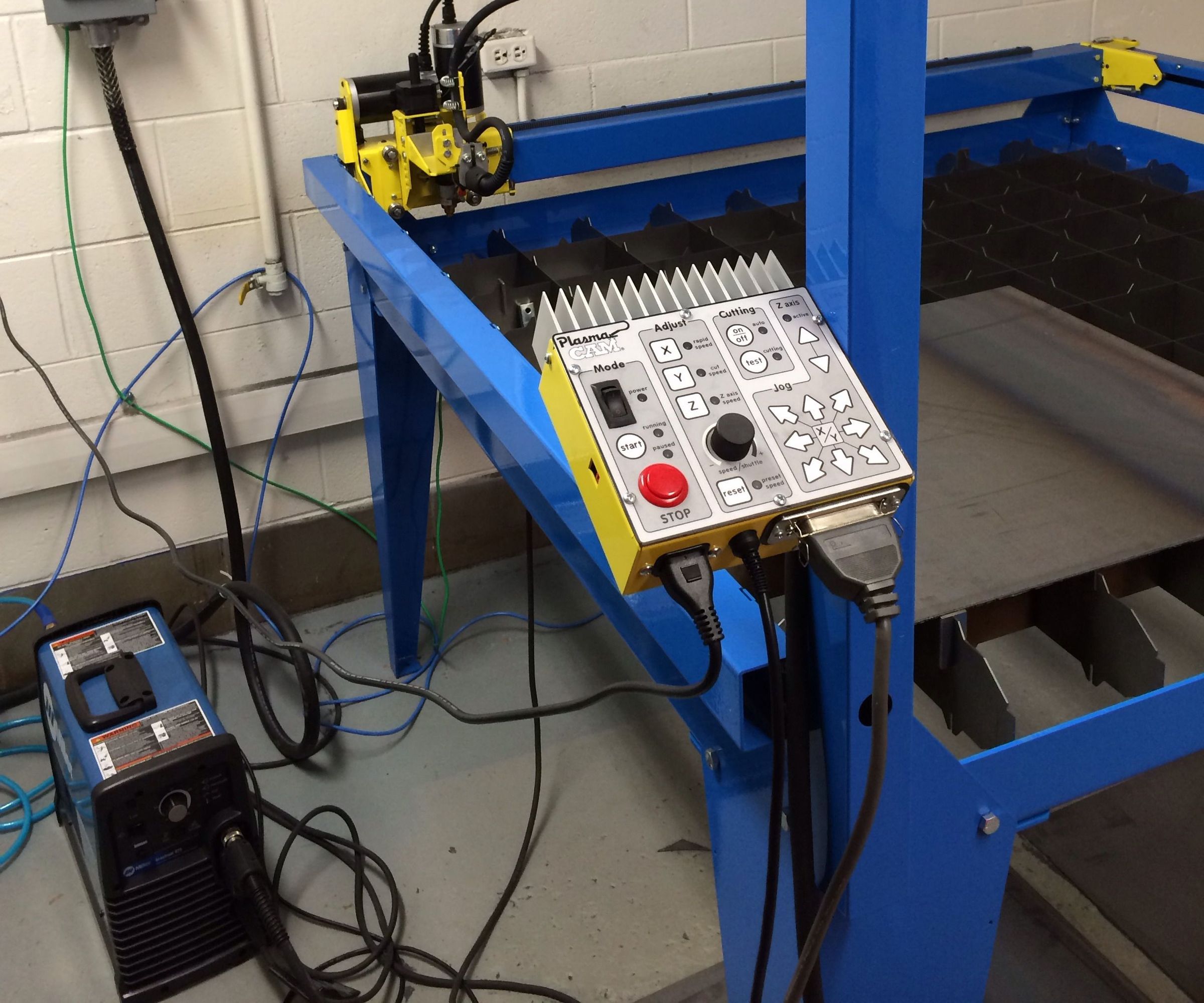

Step 2: Power on the Machine
Check the plasma cutter breaker in the breaker box, then flip the switch on the plasma cam control board after that move the lever on the main power supply to the plasma cutter to the on position, then power on the plasma cutter and wait for it to show no error codes (as pictured).
