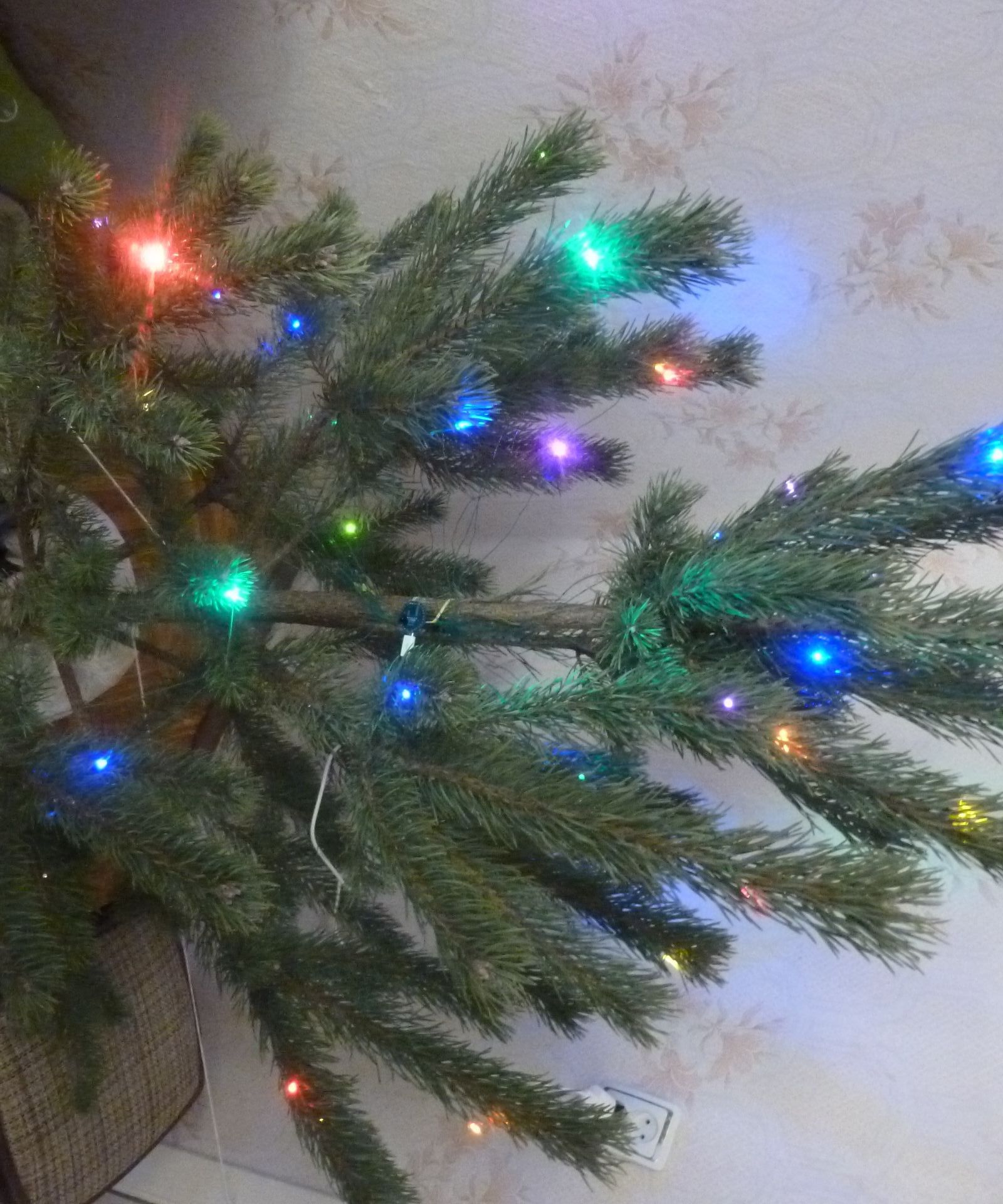

In the end the garland clock was showing time in dashes: long one for hours, two short ones for minutes. In the following year I filled my home with very different variations of the same device, most of them sporting more than one LED, but the principle remained (check the video). The only thing I’m not sure about nowadays is the white color for 9: I think I should make it a bit more pinkyish to avoid confusion with Cyan. It may have been better to insert white between two Cyan hues of the 10-color cycle, but now it’s too late for me, as I’m already pretty used to these clocks as they are.

The second informative function of my garland was the thermometer. In fact, the thermometer itself was my first Arduino project, and it is still working nearby, showing outside temperature on a binary ‘display’. The garland was to request the data from it via I2C interface and display it in RGB.
It is possible to use the same approach as described above regarding minutes, that is, a digital one showing tens and ones. However, as the temperature can go in negative, this approach becomes not that intuitive. I also needed a different way to show temperature to avoid confusion, as both clock and thermometer were to work at the same time. So I used an ‘analog’ approach here.
The 'analog' approach means you don't have to convert seen colors into digits, you may just associate colors with how the weather feels. Like this (from cold to warm, for the winter):

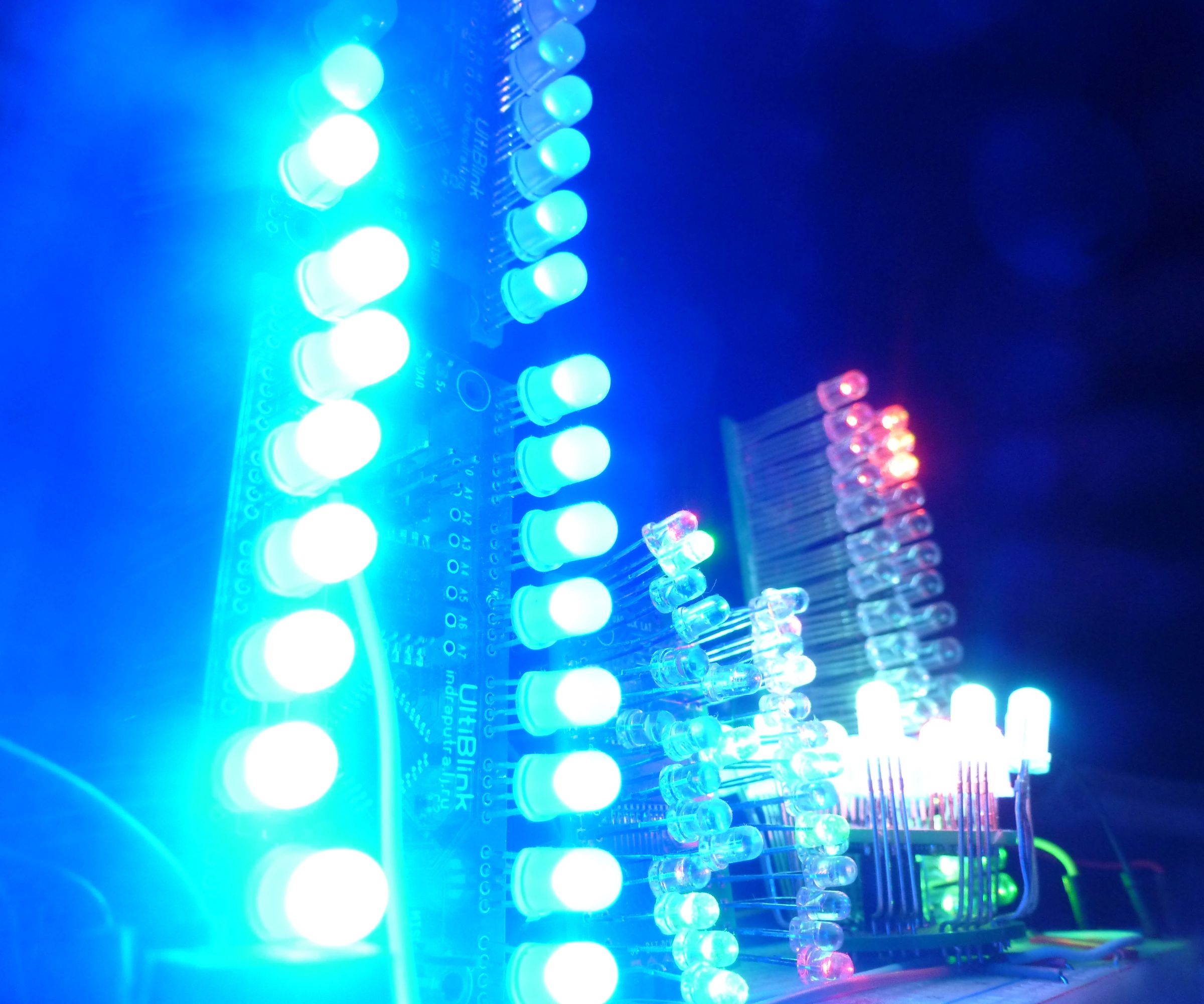

After the garland was made and used, I moved on with LED experimentation, acquainted myself with LED drivers, started experimenting with home-made PCBs. One of the first such PCBs included two LED drivers (DM631) and was able to host ten RGB LEDs. A bit later I found a small wooden coffer in one of the shops and decided to marry those two. In fact, I wanted to make some unusual stuff as a present for a friend of mine. In any case, the end result was a clumsily soldered home-made prototype of the CofferClock (the device I’m so proud of now that even am trying to sell the newer versions). As this was an early prototype, it required some real-life testing, so I took it with me on a holiday to use as a bedside clock. And there I found that it lacked an analog clock mode.
Example: you wake sometime at night. You don’t need to know the exact time, you just want to know whether it’s night or early morning and how much sleeping time you have left. With a regular OnePixel clock, especially when you’re more or less new to it, it takes some time to understand what it is showing (which color is hours, which is minutes). A single color showing approximate time would be better, so I needed an additional ‘nightlight’ mode.
The rest it easy: I took a basic spectrum circle from red to red, applied my 6-hour-clockface convention and dropped in some brightness-based animations for extra coolness. Colors change seamlessly over the hours, so very red-ish pink is something like 5:50, orange is closer to 7, cyan generally means three in the morning, etc.

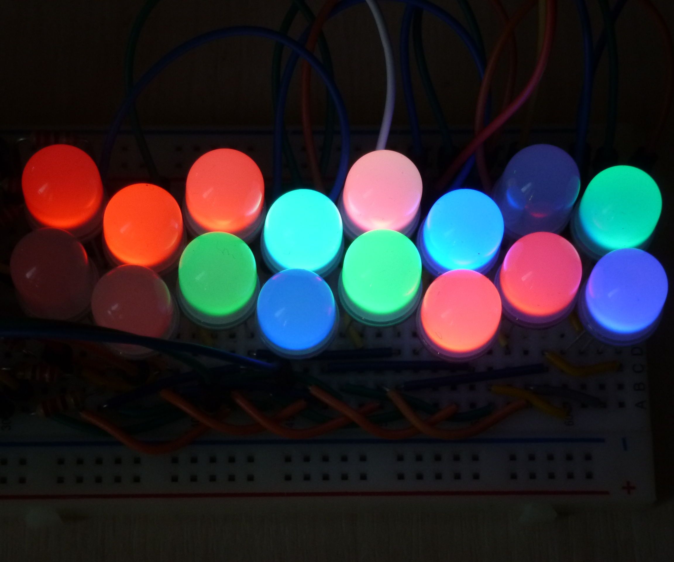

Step 7: Calibrate Your LEDs!
You may have noticed the RGBready[][] arrays in my sketches; they hold all the preset values for the colors I use in clocks and other stuff. Why not a simple equation like yellow = 1/2 red + 1/2 green (or 127, 127, 0 to be precise)? Because RGB LEDs are not color-calibrated in any way and if you want them to display exact colors you have to hand-pick the values.
The video above shows five LEDs of different sizes being fed exactly the same values. Even on video you can see the difference in their behavior; in real life it’s much more pronounced – it seems like the big 10mm LEDs are actually acting on a different time scale than their smaller cousins. They are not, they just display blue totally differently which leads to different transitions between the colors, most notably between blue and red.
Blue, in fact, is the most problematic color on RGB LEDs: sometimes it’s deep and dark, sometimes it looks almost like cyan. Green can also change noticeably from yellowish warmer hue on one LED to cool bluish one on another. Green is also almost always insanely bright and tends to ‘swallow’ neighboring colors – so I usually tone it down. Red is the most reliable LED of an RGB LED: again, usually. It also is the weakest, and not because of its different Amps consumption, but due to the way our eyes perceive red color.
In any case, the only way to make color scheme as close to ideal as possible is adjusting the color values by hand. I keep a bunch of these RGBready[][] arrays for different LEDs, although I usually still have to make some adjustments for individual projects.
I actually intended to include a sketch for a simple LED-calibrating device here, but it turned out to be more complex than I thought: three potentiometers and an Arduino are not enough. So I’ll keep it for another instructable that I will publish soon. Until then – thanks for your time, comments and suggestions welcome!
