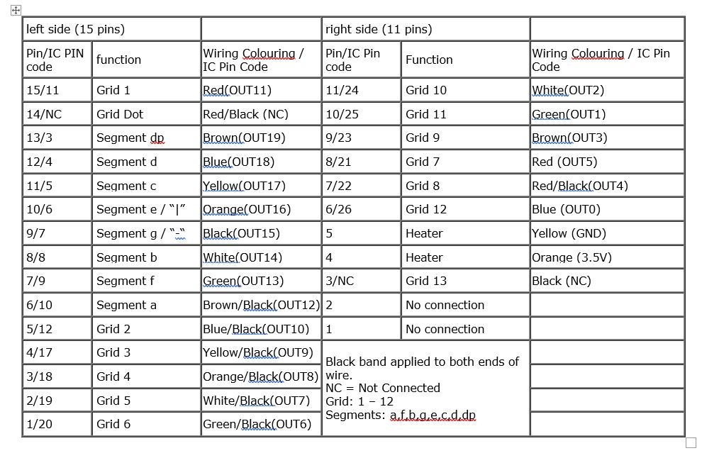

Step 1: Pin Assignment of IV-27M
Cathode Heater Voltage
It is very important to use 3.5V. There have been some references to using 5V on the internet. While this could be used it will over-heat the grid heaters. To see this in operation view the IV-27M tube, while it is working, in a darkened room, the two heater lines can clearly be seen glowing red!
Pin-outs

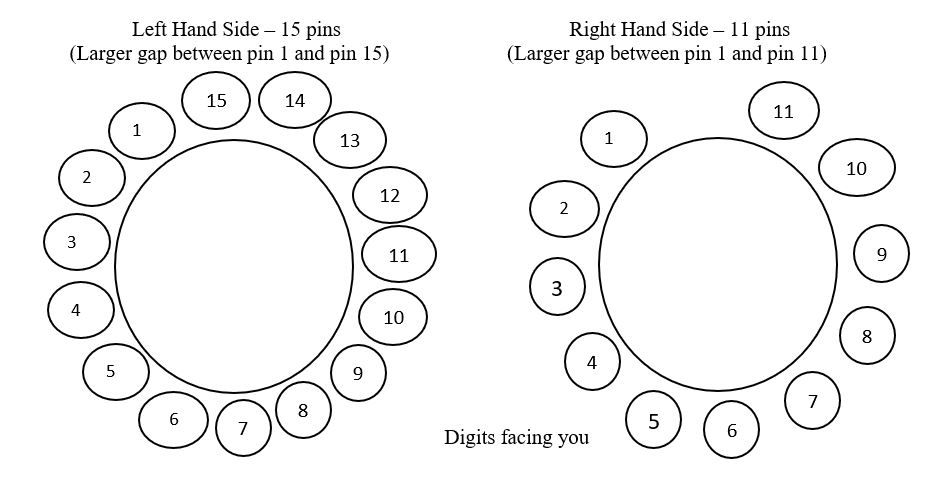

The first part of the project was to determine the pinouts on the IV-27M tube. There are Russian language-based datasheets and numerous Internet based descriptions of the left and right pinouts. Looking at the tube with the digits facing you, the left hand end has 15 pins and the right hand end has 11 pins. I simply soldered coloured 30 Gauge wires to both ends terminating in Dupont breadboard pins. Six of the left hand wires and one of the right hand wires had black heat shrink bands added to each end in order to differentiate them from the other solid colour wires.
The above chart details the 15 pin connections on the left hand end of the tube, and the 11 pins connections on the right hand end of the tube. Note that pins 1 and 2 on the right hand side are not used, pins 4 and 5 also on the right hand side are for the heater.To help wire up the correct tube wire to the appropriate MAX6921AWI connection I have added these connection details in brackets alongside the coloured wire for each of the pin connections.

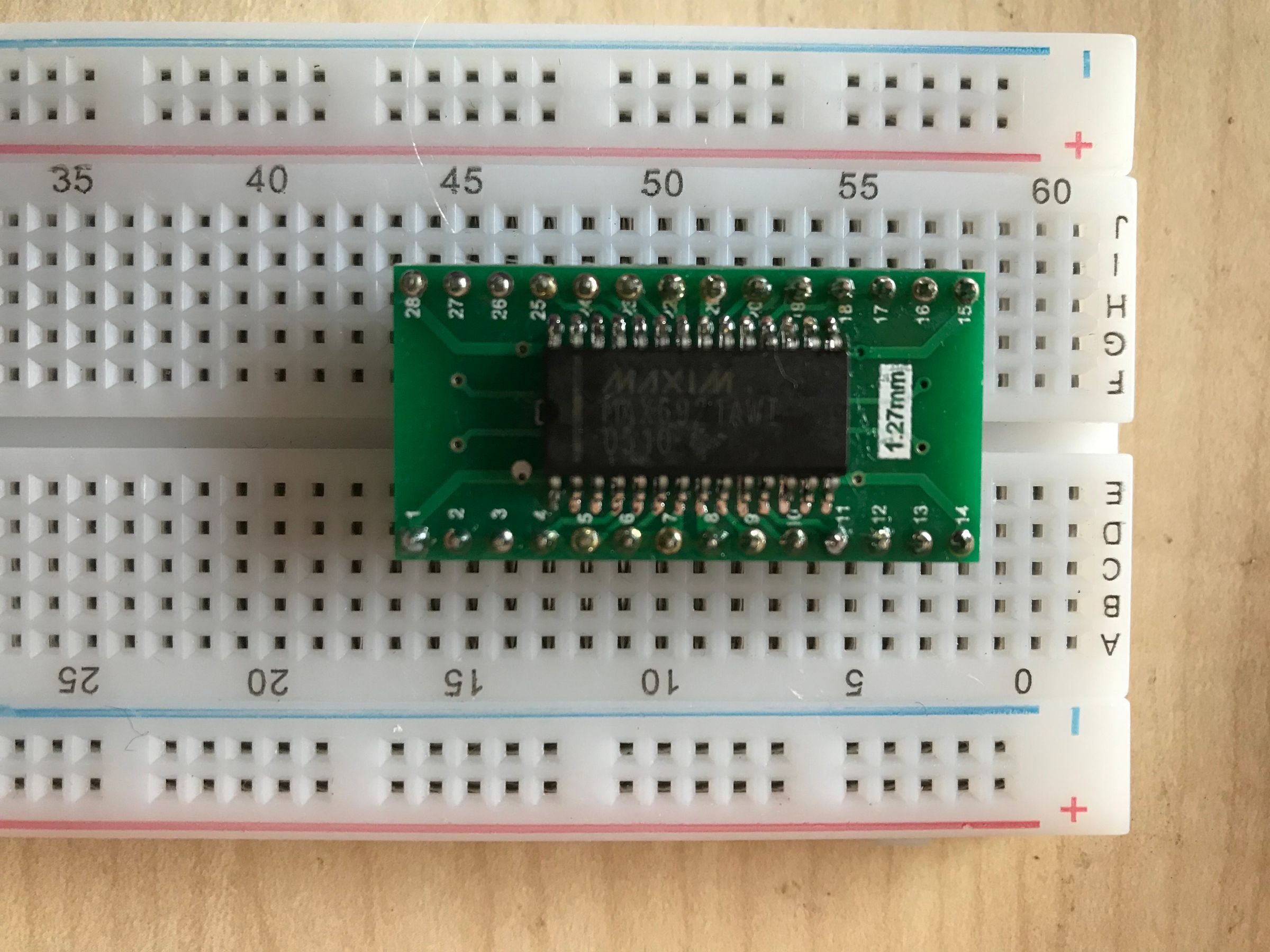

There are 28 pin-outs on the MAX6921AWI chip all expect "DOUT" and "BLANK" are used in this project. It was not possible to support all 13 grids on the IV-27M with this chip, however for use with a "standard" Hours, Minutes, and Seconds clock it is the chip to use. I purchased this chip rather than the MAX6921AUI version as the solder points on the AUI version of the chip where just too small for me to solder while the larger 1.27mm solder points on the AWI chip where larger. You should check out "You Tube" to see examples of how to solder this chip. Put simply, I added flux to the PCB board, with a small amount of solder on the end of the soldering iron ran the edge of the iron along each of the 28 solder pads.I positioned the chip with all 28 legs over the 28 soldering pads and held in place with tape, I then pressed the soldering iron down onto the edge of each leg until I could see the solder run, (using a magnifying glass helps greatly here). Once complete for all 28 legs I used a continuity meter and tested between the top of each chip leg, as it goes into the chip, and the bottom of each PCB pin which I had previously soldered onto the reverse side of the CB board.I have a new set of chips and boards arriving shortly and will do a video of this soldering and place it here and on "You tube".

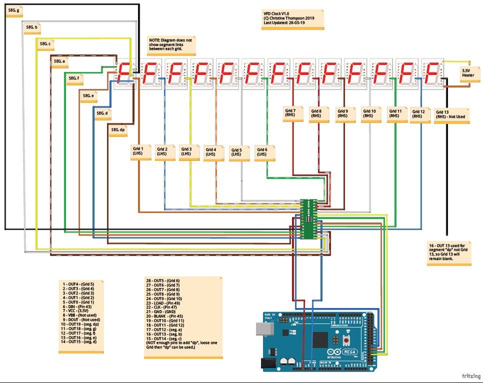

Firstly, my great thanks to Kevin Rye for all his help with the understanding and help with how this IC chip works. The attached Fritzing MAX6921 schematic details the connections required to power the 10 grids and 7 segments within each grid. In brief each grid is displayed one at a time with the remainder blank. This is repeated for each of the 10 grids, upwards of 40 times a second. Based on the principal employed in the film industry where 35 frames are displayed per second. Each of the frames is a single still image, however as 35 of these images are displayed every second the human eye cannot distinguish any individual image so these images blur into a moving image. This can be best seen using an iPhone camera to film the displayed characters, the recorded film shows the characters fading in and out.
MAX6921AWI SOLDERING
It is necessary to purchase a TSSOP28 PCB pin converter board, this allows the 28 pins of the MAX6921AWI to be soldered to a PCB board which has 28 traces which in turn attach to 28 header pins, these pins are what are used to attach the wires from the tube, power supply and Arduino Mega board.
NOTE: Use a bread board to accurately position the two sets of 14 header pins under the PCB board, prior to soldering them to the PCB board.

The attached Fritzing diagrams show how the various components are attached to the Arduino Mega and just as importantly how the IV-27M is attached to the MAX6921AWI chip. Each wire attached to the IV-27M was colour coded with similar coloured wires having a black heat shrink band applied to both ends. It is very important to also heat shrink the connections to each of the wires coming out of the IV-27M. Each of the connection wires are terminated with a PCB female pin and heat shrink is applied. I added a small power distribution board which was fed with 12V from the power adapter, which is turn powered the 12V to 24V DC-DC boast converter and a 12V to 5V DC-DC step down converter. This 5V supplied the Arduino Mega board, LCD screen, and speaker. The BME280 and MAX6921AWI both required 3.5V so were powered via the 3.5V output of the Mega board. A single LED lamp was powered via 12V.
Alarm Clock Schematic
(Incorrect MAXIUM chip diagram used, Fritzing system does not have a suitable MAX6921AWI diagram)
MAX6921AWI Schematic
