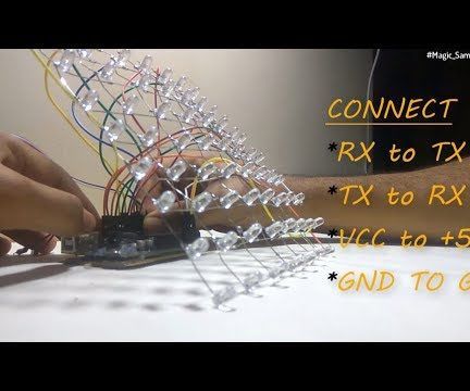

Step 10: Connect Bluetooth Module
Configuration of Hc-05 Bluetooth module
* Rx-Tx
*Tx- Rx
*Vcc-5v
*Gnd-Gnd
