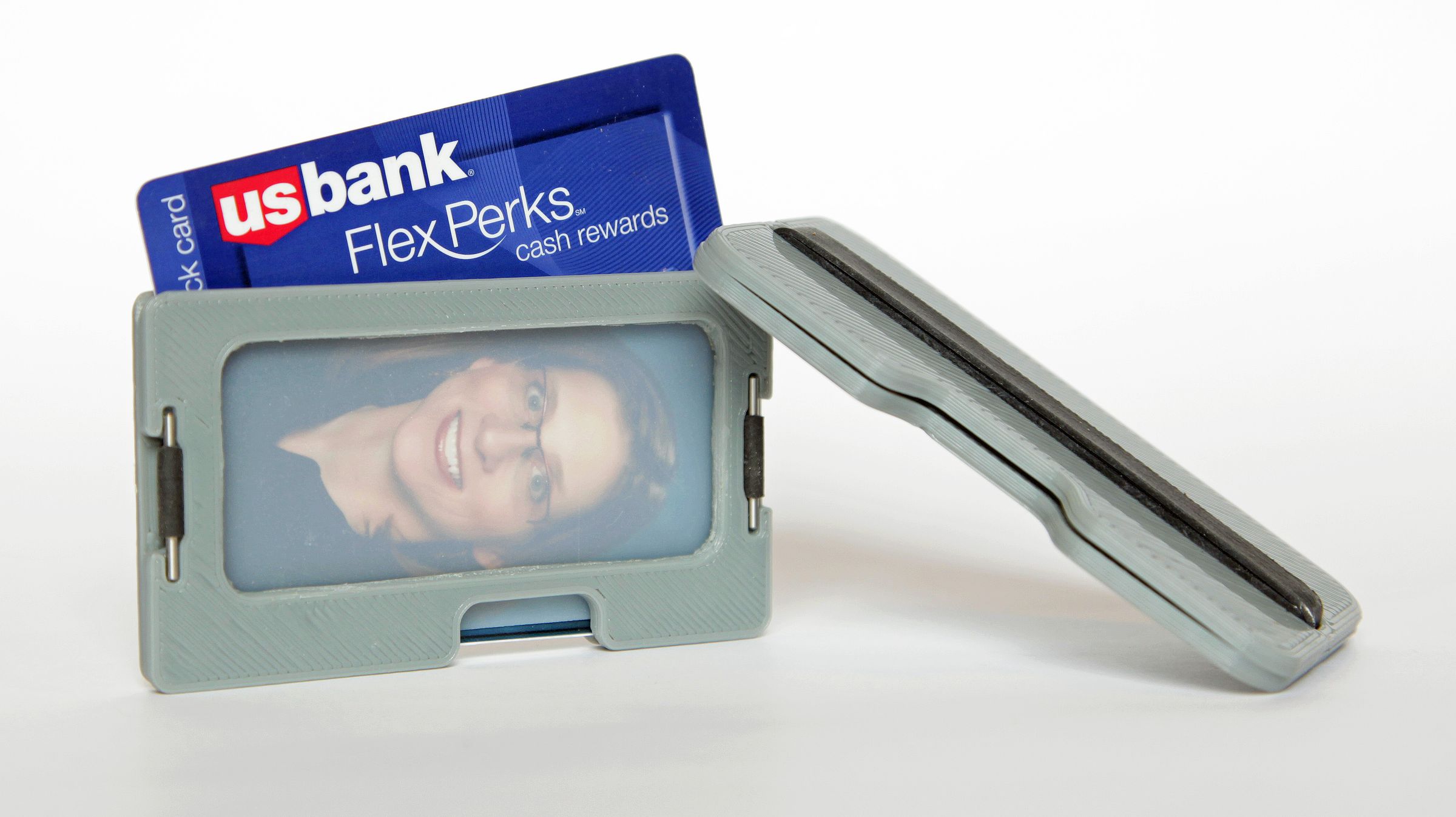

Print your own Veos wallet and enjoy a great front pocket wallet experience. The 3D printed frame holds cards that slide out the side for use. Then, put a picture of a loved one behind the frosted window to enjoy, or an I.D. that makes for quick I.D. checks at the store. There are even two different sizes available. A λεπτός wαllet that is .22" thin and holds up to 4 to 5 cards. And, a τακτiκός wαllet that is .38" thin that holds up to 7 to 8 cards. The rubber band holds cash and receipts on the back, as well as holding as few as 1 or 2 cards securely in place on both models.

Okay, gather up the printed wαllet, rubber band, dowel pins, and frosted window.
Push the rubber band through one slot from front to back. Pull the rubber band through about 95% so a small loop is left on the front side of the wallet. Slide the first pin through the rubber band loop. Next, pull the rubber band taut from the back. This seats the first pin.
Now, pull the band taut again, use the screwdriver to push a small loop of the rubber band through the second slot. Push the second pin through this rubber band loop. Lastly pull the main loop of the rubber band loop taut to seat the second pin.
