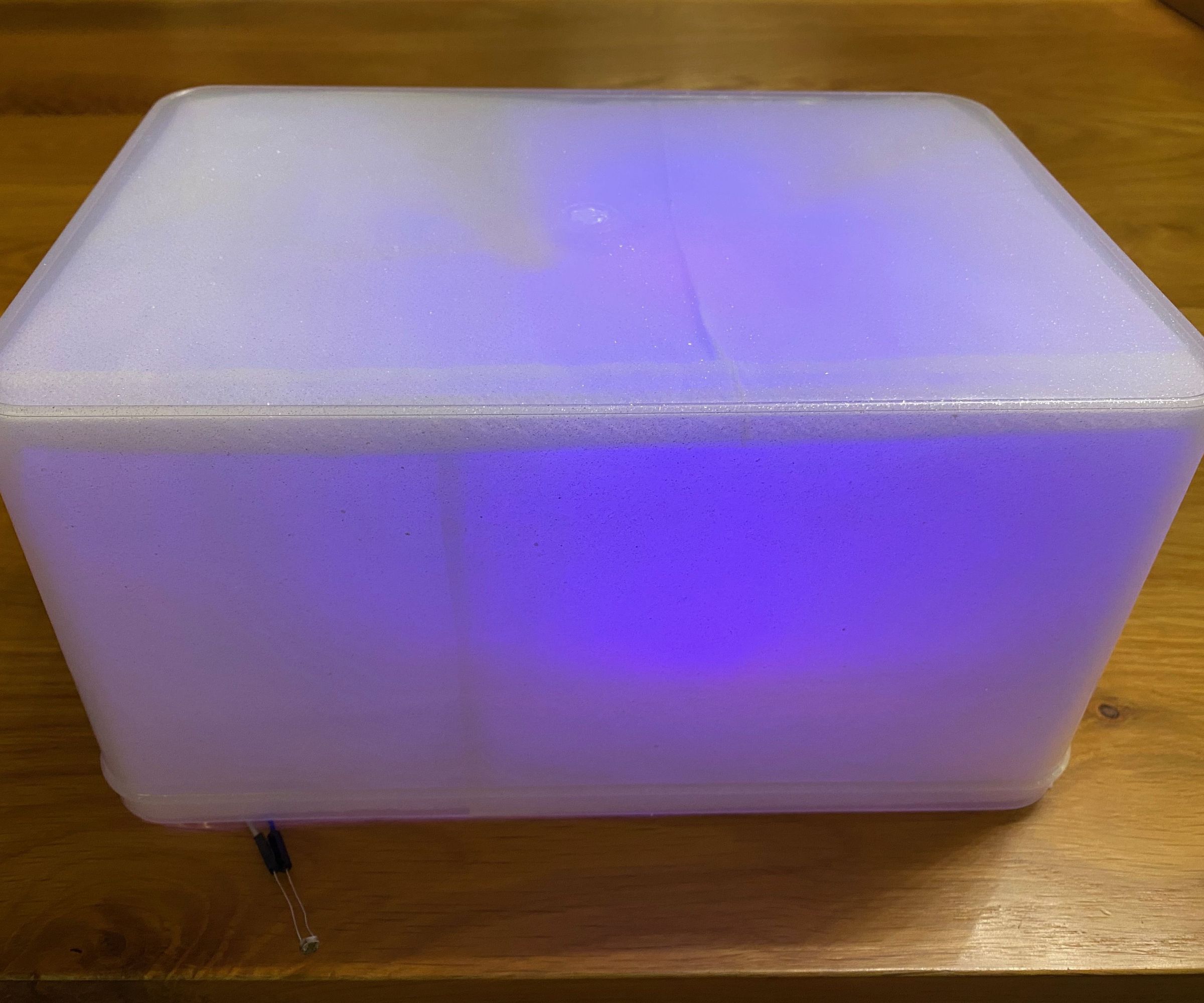

This is an example of ultrasonic sensor with LED in the use of detecting water level.
Most of the people put water beside their working table, and this machine can remind and warn the user about the water level.
This machine will detect the water level in the bottle. Whenever the water level is higher than 2/3 of the bottle, green LED will shine. When the water level is about 2/3 of the bottle, green and yellow LED will shine. When the water level is less than 1/3 of the bottle, all three LEDs will shine, include the red one.

Step 5: Build and Decorate
1. Put Arduino inside the box
2. Use utility knife to cut three little holes, just about the size of LED, on the cover of the box, and stick the LED from inside to outside.
3. Stick the LED onto the cover of the box, use removable mounting putty to stick it from inside.
4. Cut off of the wings at the cover of the box.
5. Cut a little hole at the side of the box, about the size of the cable, so the cable can connect Arduino with the computer.
6. Stick the bottle on the top of the box using the acrylic foam tape.
7. Cut a little hole just beside the bottle for the use of letting the wires of the sensor out. You don't need to make the hole too big, just big enough to let the sensor out.
8. Stick the sensor using removable mounting putty at the edge of the bottle. You will want to stick at the opposite side of where you will pour the water so the sensor won't get wet.
