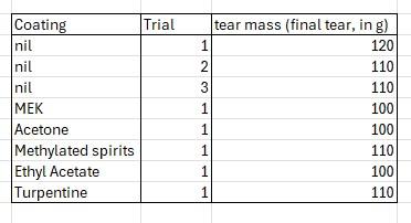

To test this I built a small jig, wherein sections of the samples were cut to a template designed to promote tearing along one axis (see the image). Essentially strips were cut 20mm wide, with a slit in the middle. One side of the slit was taped to the tabletop, and weights suspended by a clamp from the other side. My theory was that increasing masses until the sample tore along the pre-defined line would give us an estimate of any shear-resistance the coating had made.
3 "nil" samples were cut from non-coated paper of the same type, to get a baseline to compare our mechanical testing results against. The results were tabulated in the attached image.
The results for our coated samples were... not great. There was no extra resistance to shear imparted by coating the samples with the silicone mixture. If anything, treating the surface seemed to slightly decrease the shear resistance.
So... strengthening the paper with the coating is a bust. The smooth surface might give it a little resistance to wear, but I don't think I'll be using paper in the future for its abrasion resistance, anyway.
