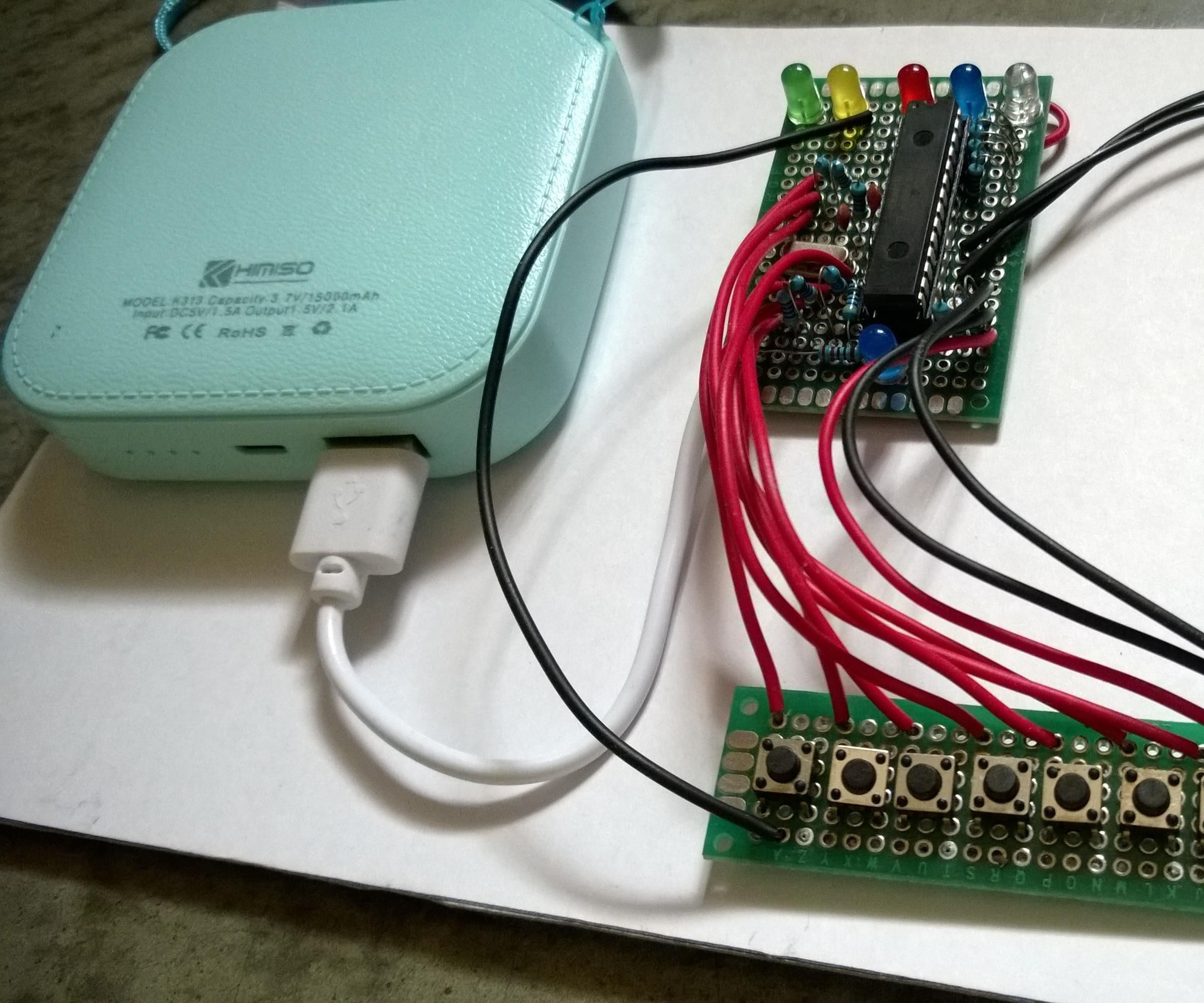

Introduction: "We Are One" (The Lion King 2) Tone Using Arduino
Components
1. Arduino (with Arduino Cable)
2. Speaker or Buzzer
3. Connecting Wires
4. Your Laptop
Step 1: Gather the Required Components.
You need the components listed above. For Arduino, you can use Uno, Mega, or Nano.
Step 2: Connect the Components Together
1. Connect the speaker to the pin 7 of Arduino and to the Ground.
2. Connect the Arduino to your Laptop through the Arduino Cable.
Step 3: Upload the Code to Your Arduino
1. Once your components are connected together, open your Arduino IDE.
2. Copy and Paste the code below to the Arduino IDE.
3. Upload the Code to your Arduino.
"We Are One" Tone Code:
