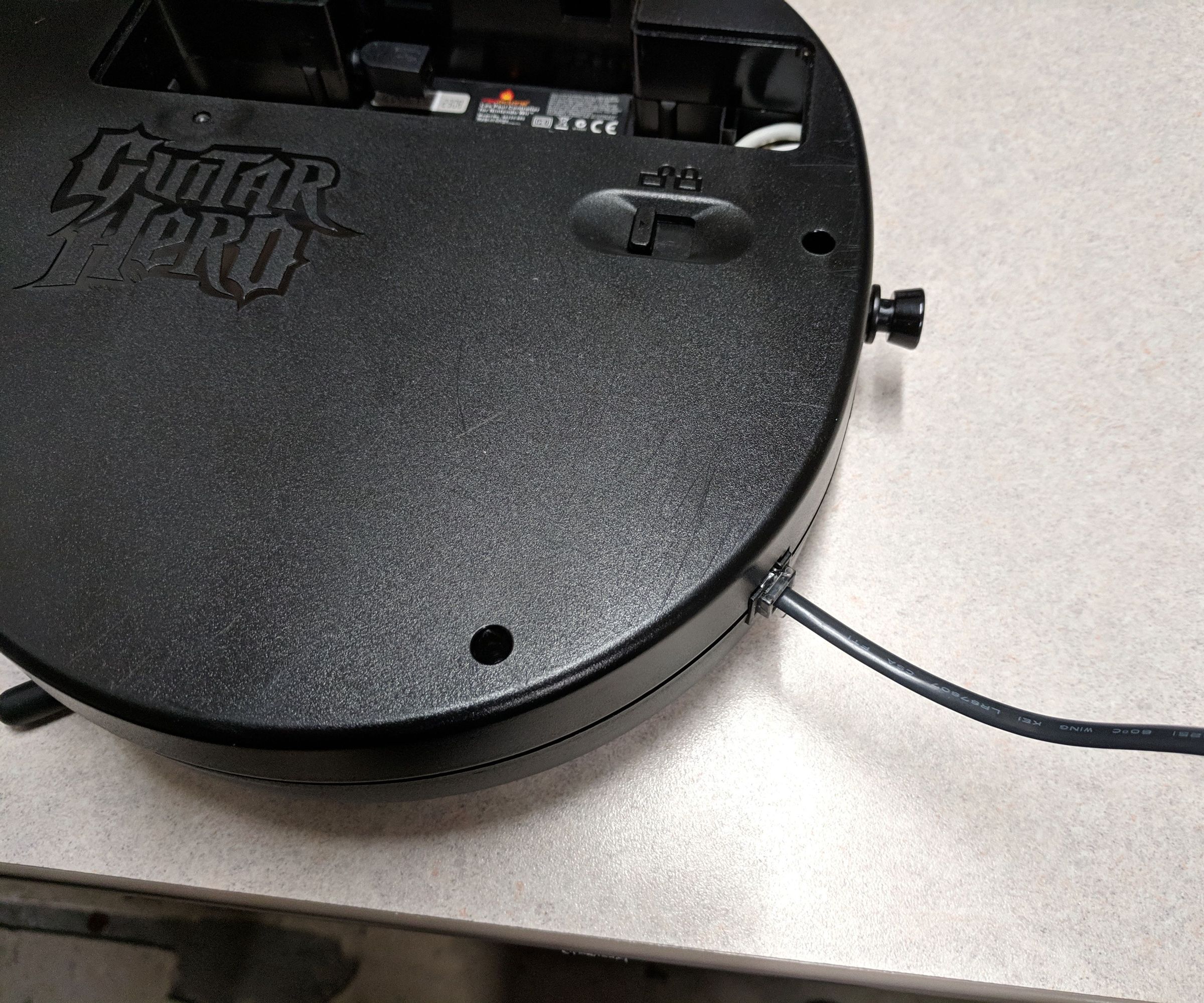

Step 4: Attaching and Routing USB Extension Cable
1. Attach the USB Mini B extension cable to the Raphnet Adapter.
2. Plug in and test to ensure there are no issues with the cable.
3. Find the path you want to take. My example is in the photos.
4. I had to slice the small amount of plastic out to make room for the cable. I did this using a razor blade. I made a slit on each side and then grabbed with needle nose pliers and moved it back and forth until it came off.
5. Cut another hole in the plastic leading to the remote slot. I cut mine to the size of the cable. Then, was able to slip the end of the connector into the slots to secure it in. You could also just let the cable dangle into the remote slot. I chose this location just in case the Wiimote is ever used so it does not interfere.
6. Add some hot glue to the wire to help reinforce.
7. Test again to ensure everything is working before we put the guitar back together.
