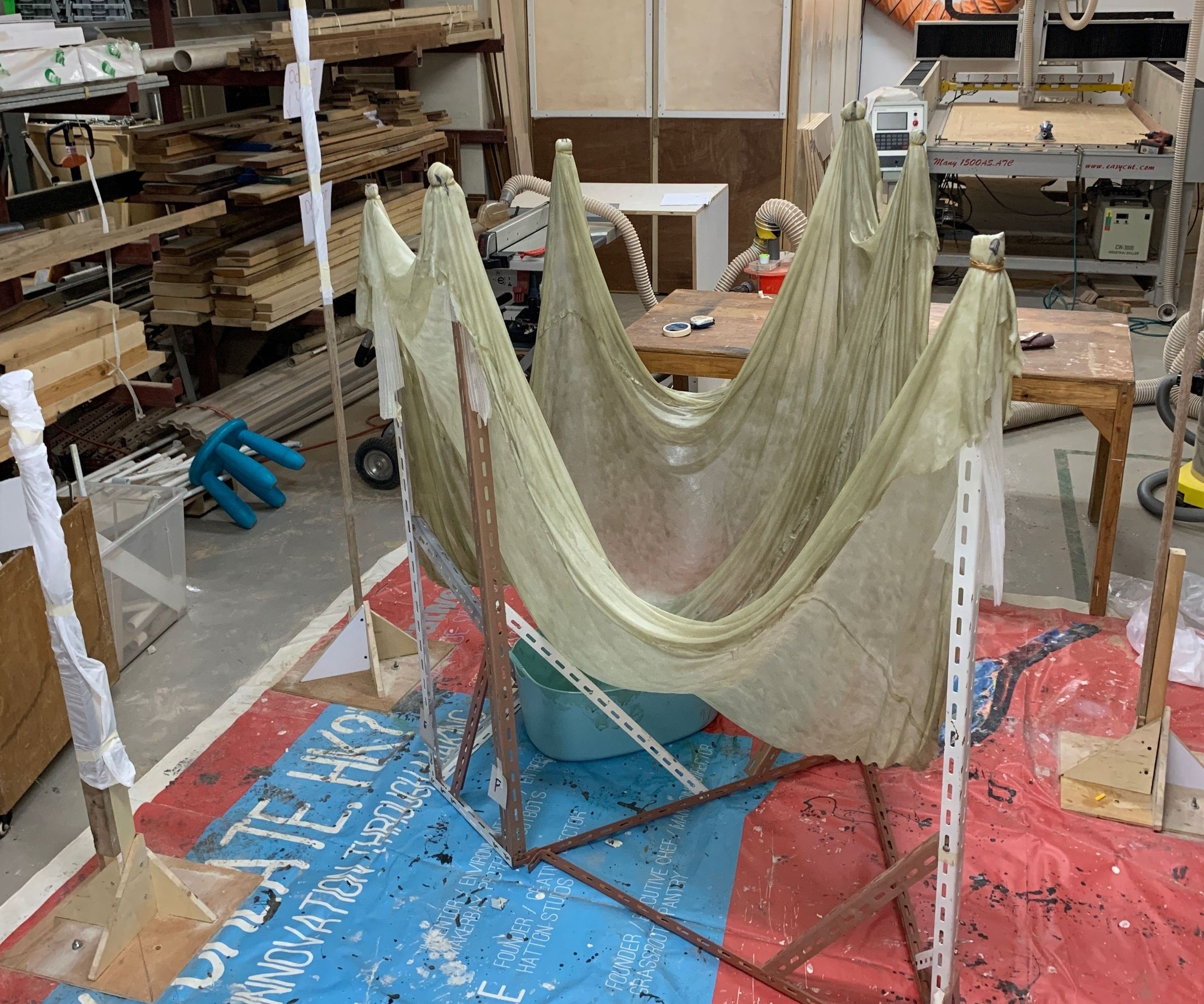

Windtrain is a modular shape-shifting vehicle that is intended to be capable of carrying heavy things with very little energy, using wind power. A hybrid of a train and a sailboat of some sort. Several versions of the WindTrain have been built already to demonstrate the concept of " Protei": Windtrain " Mister T", " Baltic", " Heads or tails", " Ace", " MakerCamp", " Farting Flamingos" (last one documented on Instructables). This is Harbour School G4B version of WindTrain, we called it "Umbrella" - inspired by the domestic accessory. It is radio-controlled. It comprises of 4 modules for a total length of 536cm, width 126cm, height 180cm. It an educational project to introduce to students the use of tools, fabrication, collaboration to prototype wind-powered machines. Further prototypes are coming. This project was developed at MakerBay, Hong Kong Makerspace and taught by Cesar Jung-Harada, Harry Churchill and Edward Ip Chi Ching with the Harbour School teachers. The introductory presentation by Cesar is here as a google slides.
