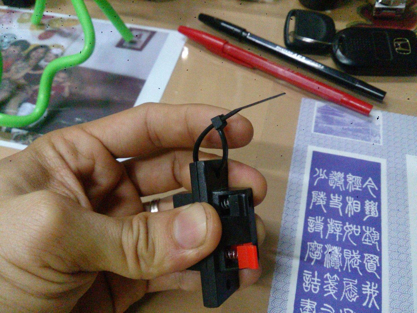

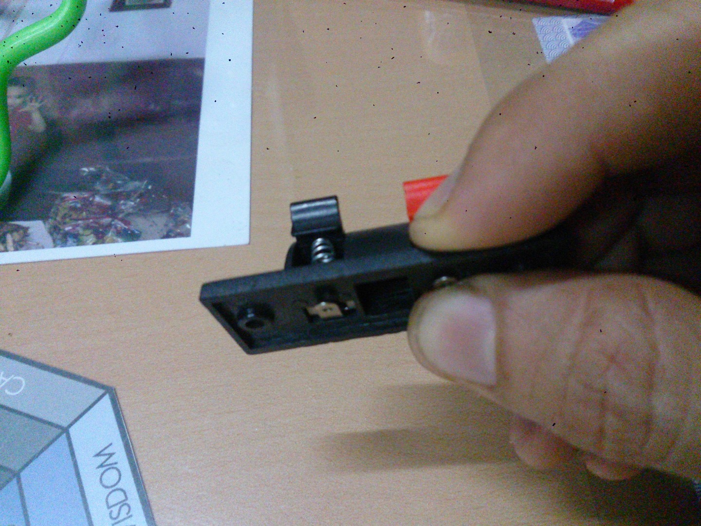

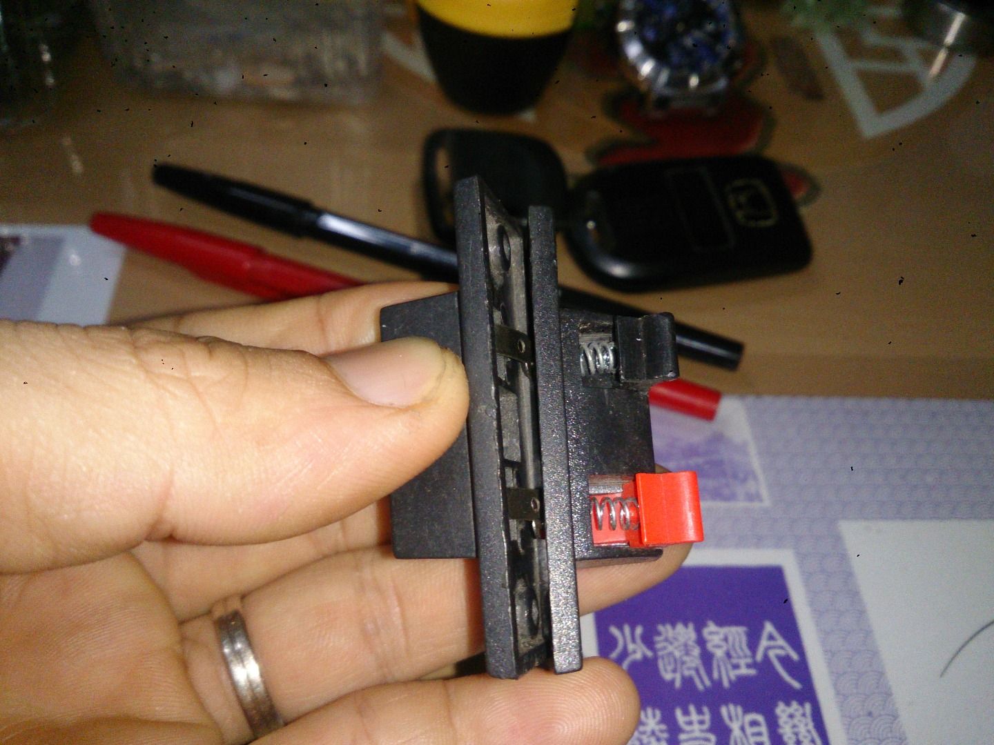

Flatten the solder pad at the back of the wire clamp terminal by pressing it with your thumb.
Two:

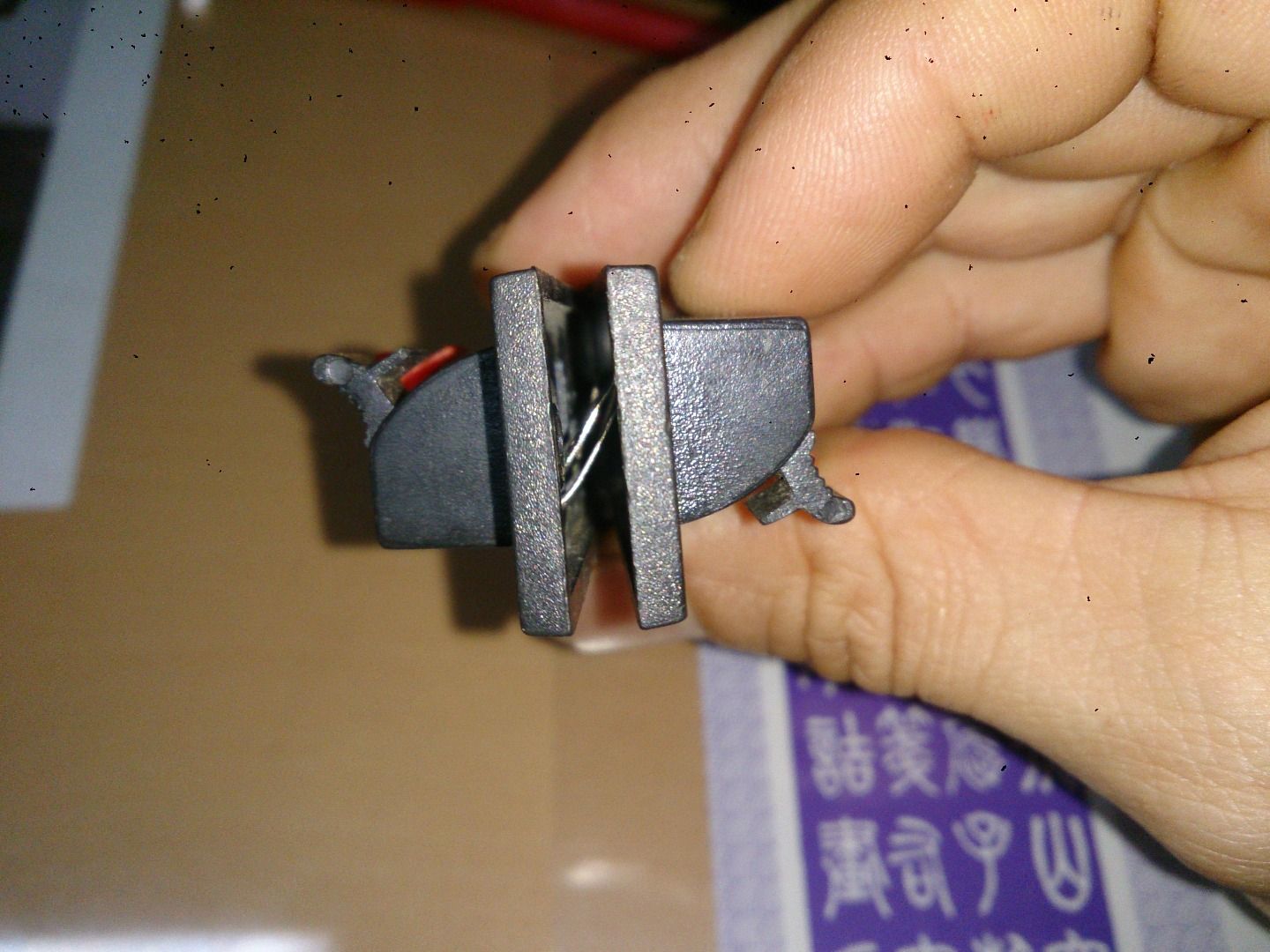

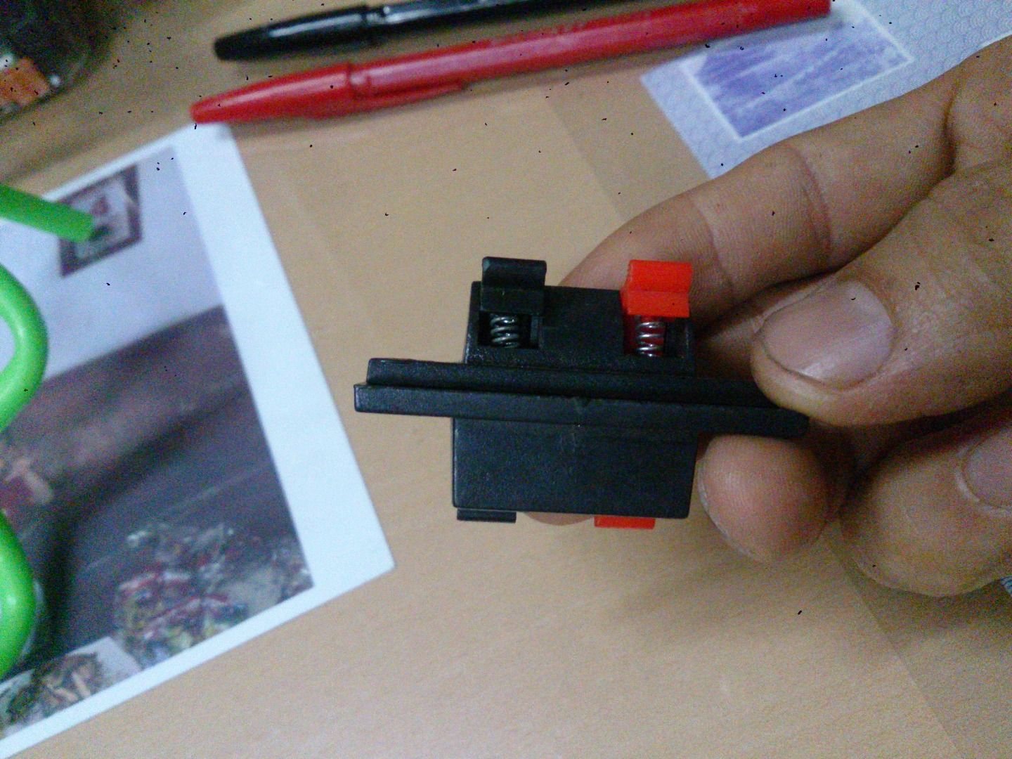

Align the back of the wire clamp terminal with the same color terminals inline (black with black, red with red).
Can you see how the solder pads clipping each other? The left pads go to the right and the right pads go to the left. Well, the picture below will tell you better the position of the solder pads from the short side. It was before I press the solder pads to the back of the wire clamps.
Three:

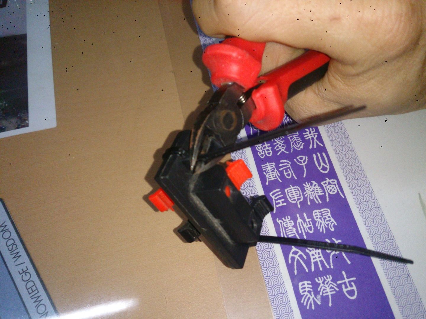

Ties the left and right holes with cable ties.
Four:
Cut off the excessive cable ties.
We are done as easy as counting one, two, three, four. ^_^
