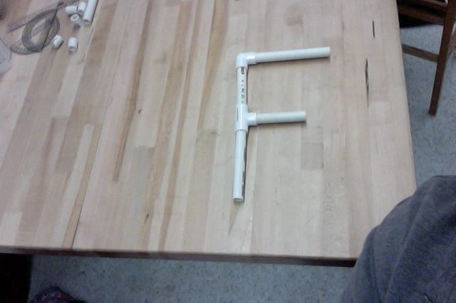

Step 4: Add PVC Cross Connecters to Your PVC Pipe
Take your PVC cross connectors and add some of the PVC pipe pieces to one of the pairs of holes across from each other. For our table we started with one of the 2” PVC pipes on left side of the cross connector and a 6” PVC pipe across from it. After that was done we just continued the pattern of cross connector than 6” PVC pipe, etc. Make sure you end with the PVC pipe.
This step should use up one 2” pipe, six 6” pipes, and six cross connectors.
