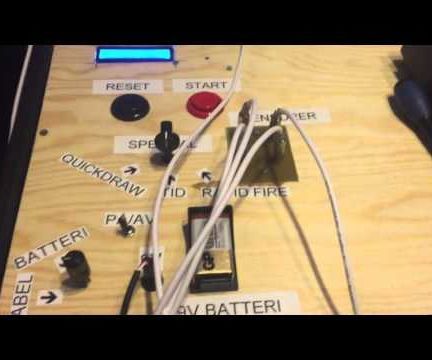

Step 2: Making the Main System
The main system i have build inside a water proof case.
- It has 4 push buttons
- Two rotary switchs
- One power button
- A battery holder
- 4 phono contacts
- 20x4 lcd display
- Terminal printer
- RTC module
- SD Card module
- 1 Transmitter
This is the main system that holds the game. You can use it with wireless or with cables. Follow the electric sheet to connect everything.
What it have is three game modes:
- Quickdraw (Shoot as fast as you can on the right target)
- Timed Mode (Shoot so much you can in 10, 20 or 30 sec)
- Rapid Fire (Hit 6, 10, 20 or 32 targets on fastest time)
I have made it possible to run on 9v power and 9v battery.
The terminal printer is to print out the result for a game, it even store the high score on an SD card.
It's important to place an capacitor on 3.3v and ground on the transmitter or else you will get problems with transmitting due to powerlost. Also there is good to shield it with aluminum foil to protect it so the other electronic don't disturb the transmitter. (Don't forget to take some plastic foil first on it. I have written more about this on the blog page (link on top.)
Visit my blog page for get updated info on the game, and the source code to program your arduino.
