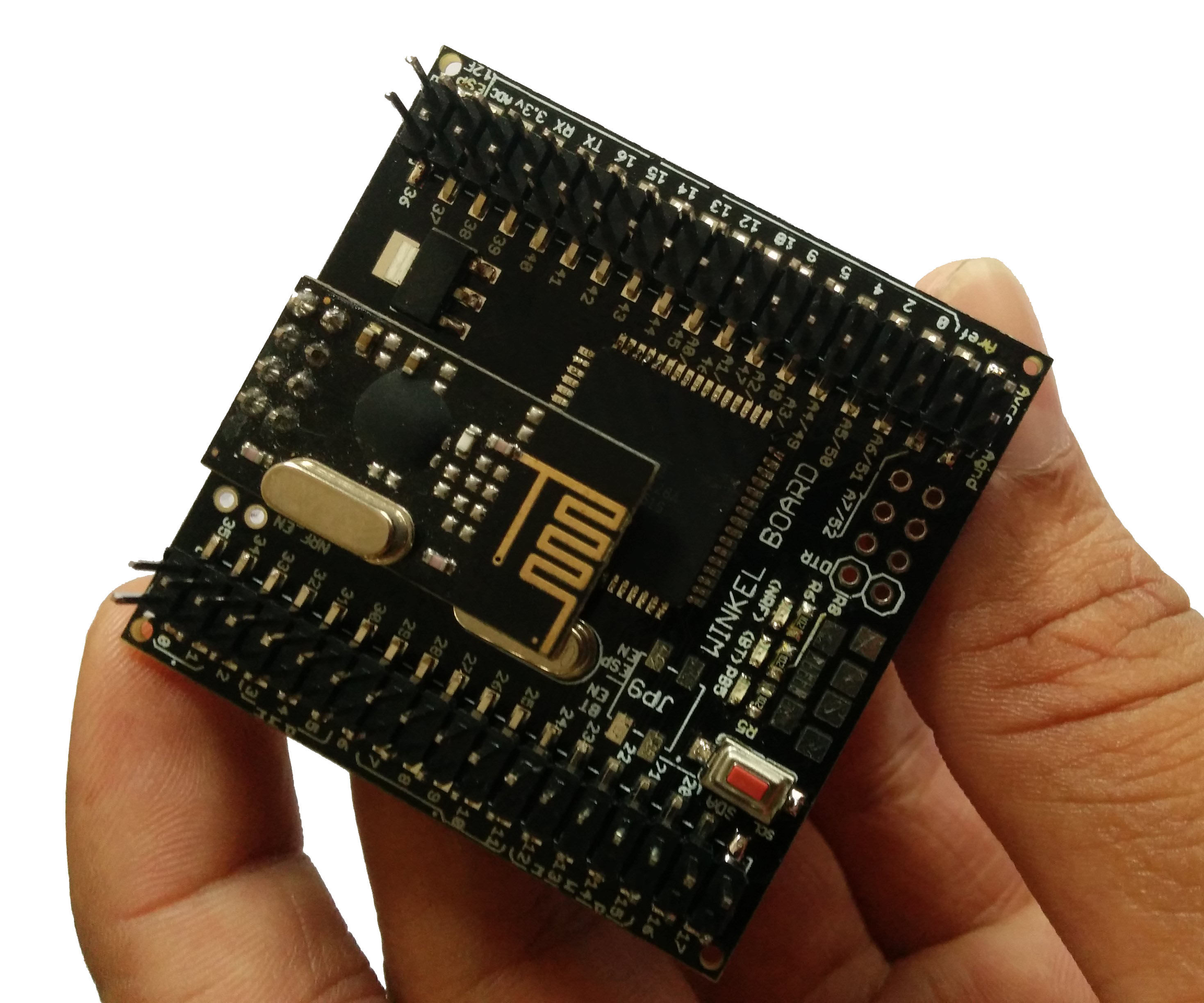

Winkel Board has everything you would require to create a sensor mesh network, because it has an onboard NRF24l01 radio transceiver module.
This example will show you how to configure a winkel board as a transmitter/receiver, how to sense information from a sensor, send that information over wireless network and what you can do with that sensor information.

The sketch is pretty basic and it tells the winkel board to see if there is any input on its Pin2 and if there is, send a packet to receiver over a pipe using radio.write() a famous method included in RF24.h library. In addition it tells winkel board to blink its onboard LED (led 13) just as an indicator that Motion was sensed.
