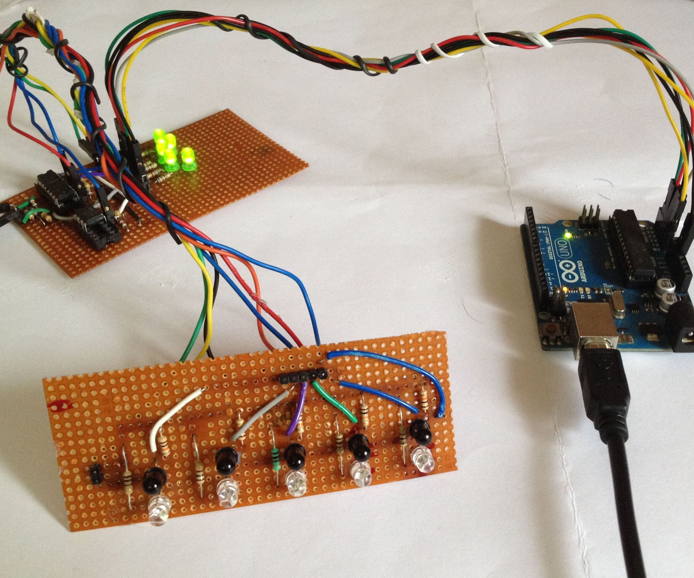

Step 3: The Transmitter : Part 2 :- Breadboard Remote Controller
This is an alternative way of controlling the bot....by building your own remote on a breadboard.
This is where the push buttons come in use...connect the push-buttons in a way that you find comfortable to control the bot (see the pics for reference).
Make sure you identify the correct terminals of all the switches.
The Connections :-
Connect one terminal of each switch  to  a common ground that is connected to an Arduino ground pin (Again refer to the pics).
Connect the other terminal to a Digital pin on the Arduino.
The connections should be something like this :-
                                           Button                                                            Digital Pin
                                       Forward ------------------------------------------->     08
                                      Backward ------------------------------------------>    09
                                      Right        -------------------------------------------->   10
                                      Left            ------------------------------------------->   11
                                      Stop         -------------------------------------------->   12
You can change the digital pin connections....but make sure you change them in the RemoteTx code as well!!
The Code :-
(1) The Tx Code :-
The code reads whenever a button is pressed since the corresponding digital pin goes LOW.Based on which digital pin goes LOW the appropriate command is transmitted.
(2)The Rx Code :-
The code receives the transmitted byte and based on the command received move the bot in the desired direction.
Both codes are attached at the bottom.
