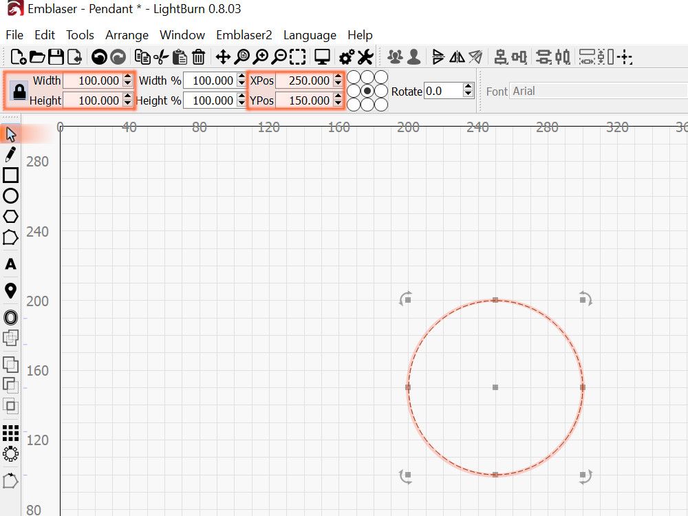

Click the Blue Colour in the Cuts Pallet, at the bottom left of the screen.
Then select the Ellipse Tool (Ctrl + E) and click and drag near the centre of the workspace to start drawing. While dragging hold down the Ctrl and Shift keys.
Tip: The Ctrl key will make ellipse draw from the centre, and the Shift key constrains the ellipse to a circle.
Next, return to the Select Tool and click on the shape you have just drawn.
Doing this will allow you to edit the shapes position and dimensions accurately, and since we are going to be aligning several shapes, it is important to get this right.
For the XPos enter 250.0, and for the YPos enter 150.0. This is the exact center of the Emblaser workspace. For the Width enter 100.0. This should automatically change the height to match.
Tip: The aspect ratio is locked by default. However, if the values do not match exactly, you can click the Lock Icon to enable you to change them individually, before re-locking the aspect ratio.
Now add another circle with the following values: Width = 20.0, Height = 20.0, XPos = 250.0, YPos = 230.0.
