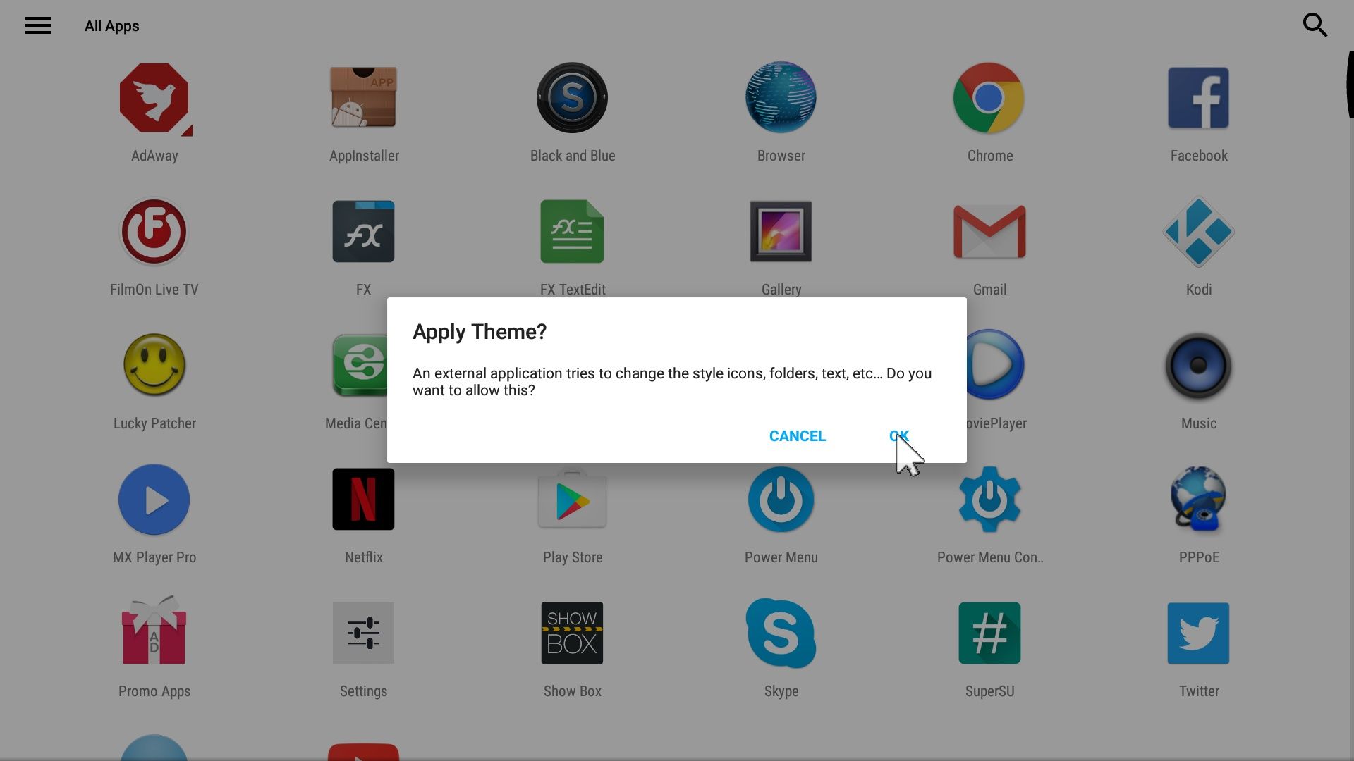

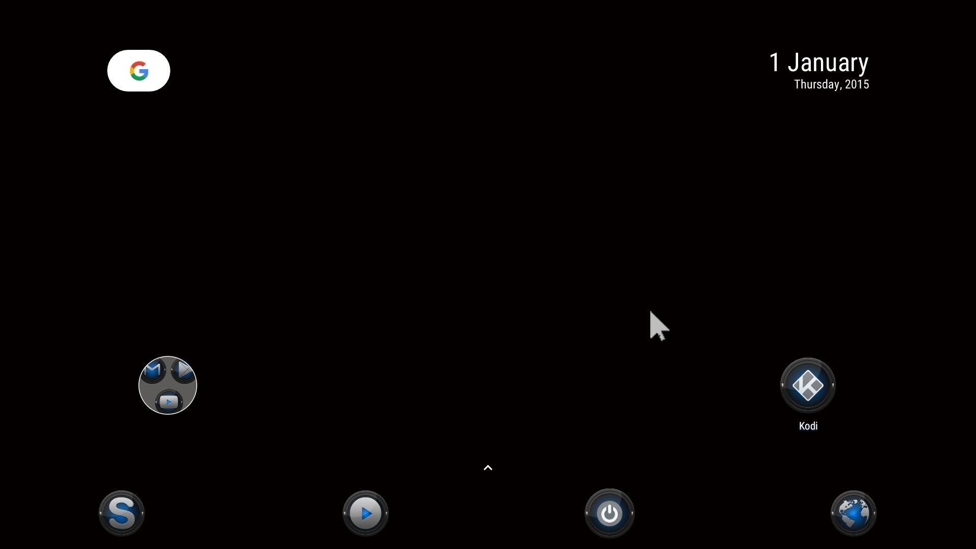

Now the box will start as normal and get back to naked Android, meaning you have to setup your Wifi and accounts.
After that Kodi will work as before and needs to update some addons and also deactivate some that no longer work - damn bloatware...
You are ready to enjoy a new box now.

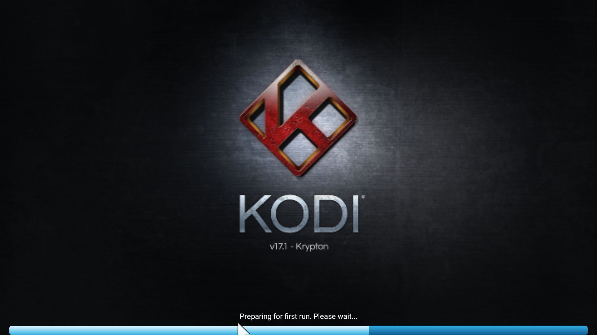

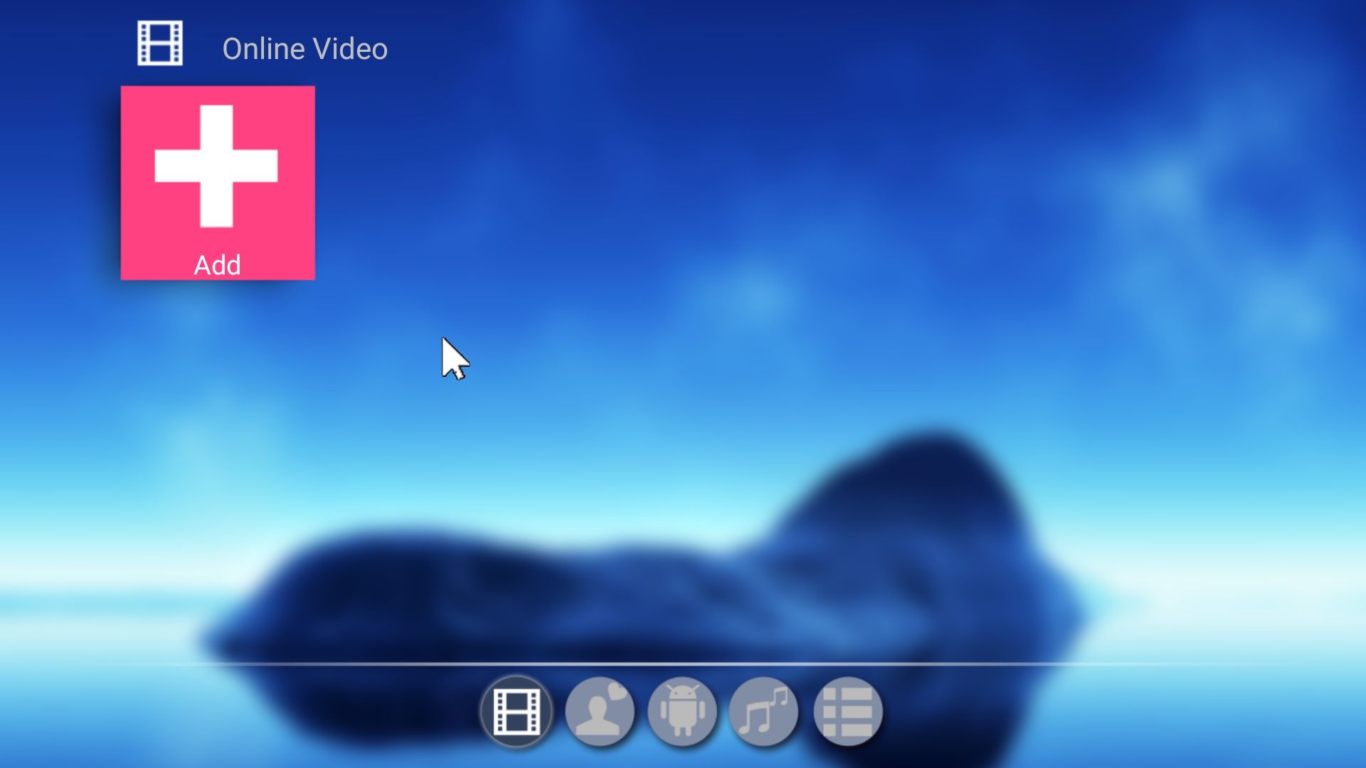

The Kodi version is now slightly different and allows for easier downloads of the stuff you watch, but I won't get into details of this.
The usual addons are all there, same for the wallpaper and menu structure you are used to.
I strongly recommend to give Kodi enough time at the first start to update and discard all addons!
Failing to do so will cause problems later on, so don't say I did not warn you.

MBox is the standard launcher as you know it
I left the standard launcher so you can check and adjust all your personal settings and see what is left in terms of programs without getting too confused by the new interface.
Once you are done simply press the HOME button on the keyboar/remote to select Kodi as the default launcher.
You can either make it permanent or set it for once and be asked again at the next boot.

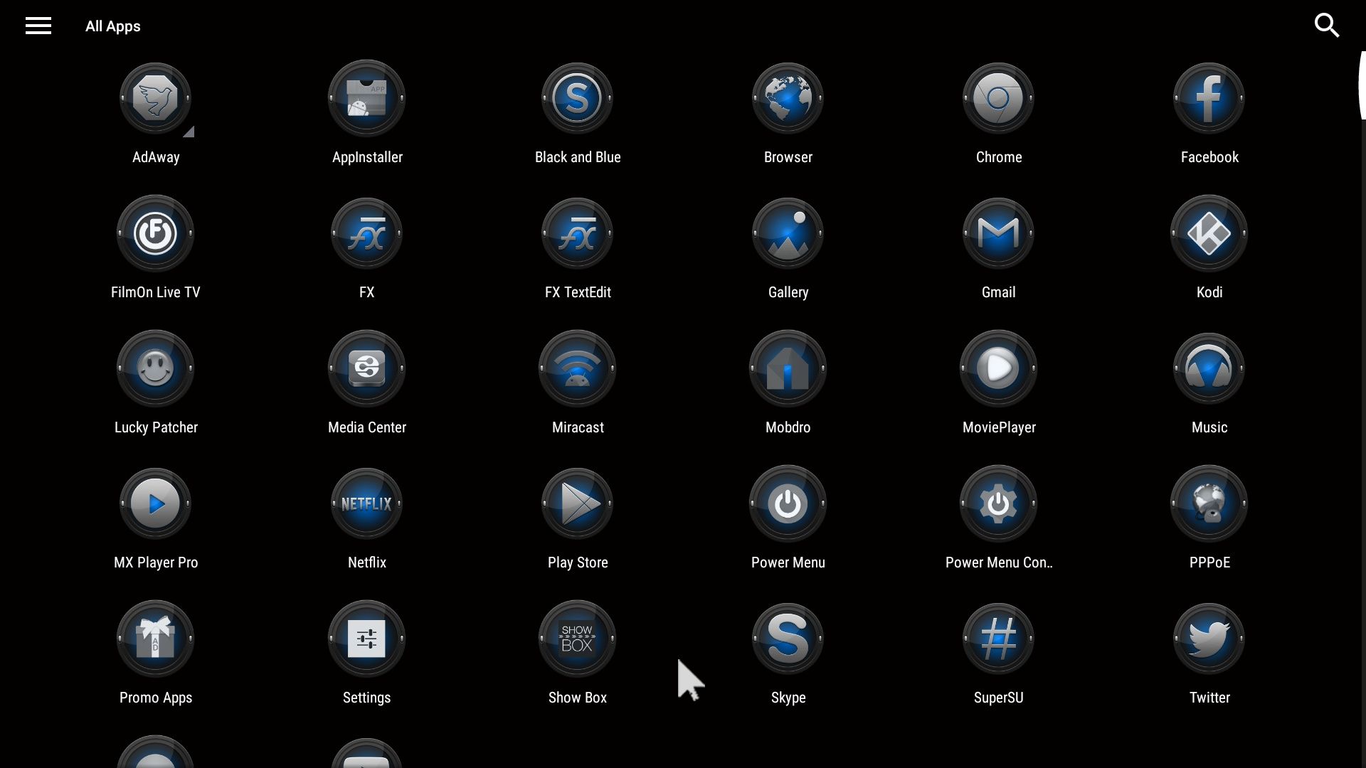

2. X96 All in
Here we have the choice of Mbox, Kodi (XMBC) or ADW as the launcher.
I highly recommend to try ADW ;)
On top of that there is also a dark theme for the ADW launcher and corresponding dark buttons for everything.
Additionally I added some programs that I use quite often and that you might find useful too.
For Kodi I added the full addon pack with all addons updated and nonfunctional ones removed.
If you want it just as a TV box you can set XMBC as the default launcher.
Android apps can be added to the favourites same way as the power menu, so add what you like ;)
The firmware flashing takes about 5 minutes after the MD5 check is over.
The first boot to the standard Mbox launcher takes about 3 minutes but from there you need to be patient while all the programs are installed.
All up expect to wait at least 25 minutes to be on the safe side here.
You will see how the shortcuts keep adding to the launcher screen....
Once the process is complete you will see the memory usage level out and stay steady around 25.4-25.85%.
If in doubt just have some dinner while the box is doing it's thing ;)
As so far I am unable to include all program and launcher settings you will have to do some manual labour which I will explain now:
To clean everything up memory wise I strongly suggest to reboot through the IR remote once the box is really done installing all programs.
This next boot will give you a selection for your launcher - click on the Media Box Launcher for one time use so you can find your way through with a launcher you are familiar with.

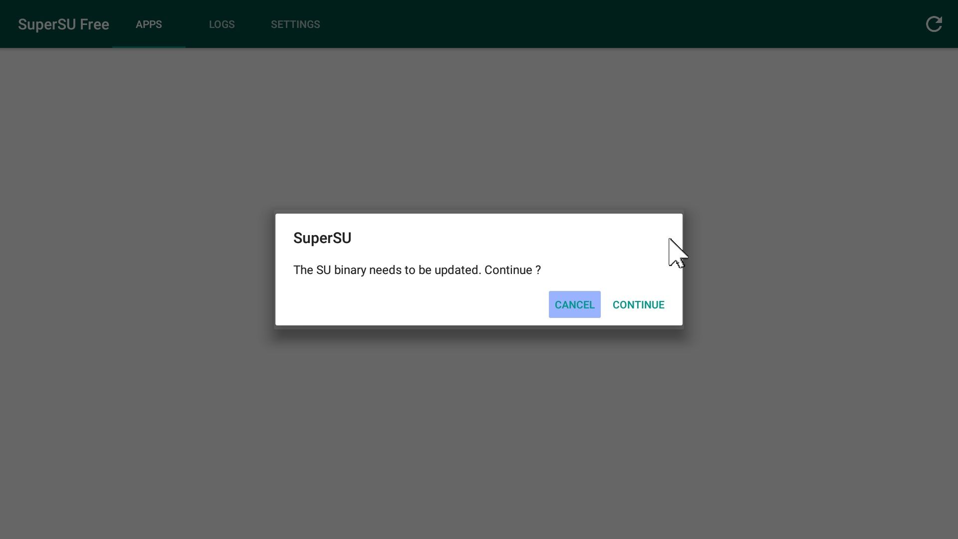

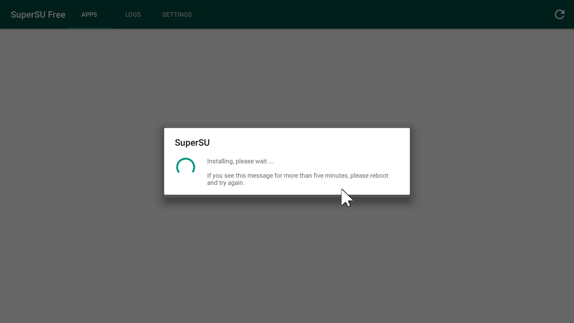

Do the network and account setup, modify your screen zoom if required and then start SuperSU so it can update the binarier (required step).
The normal way works fine, if not the first time wait a minute or two and try again, SuperSU needs all background activities to be dormant so sometimes you just need to try until it works.
For me I never needed more than 3 attempts if the first failed.
Reboot now as indicated by SuperSU.

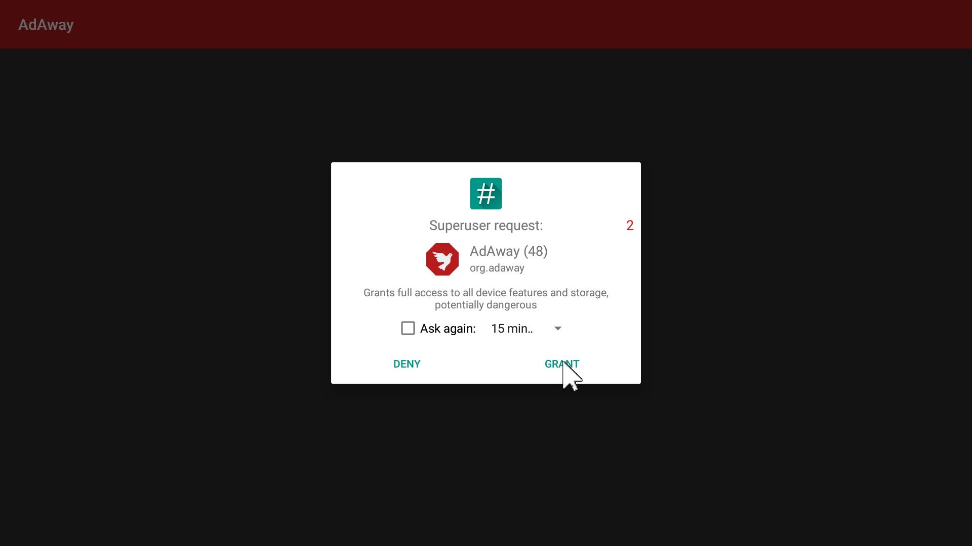

Of course several apps will need root access through SuperSU, so please grant them this forever to make it ork properly.

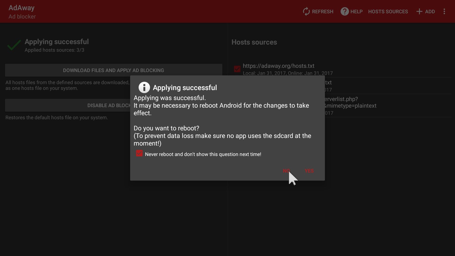

Next step is to activate the AD blocking by starting AdBlock and downloading the lists.
If you don't like reboots then tick the box for never and say no to reboots.
Only means the new lists will be active after the next boot of the box.
If you have use for Lucky Patcher I suggest to start it now and download the custom patches and usual lists, otherwise just leave this program alone ;)
Time to add some fun :)

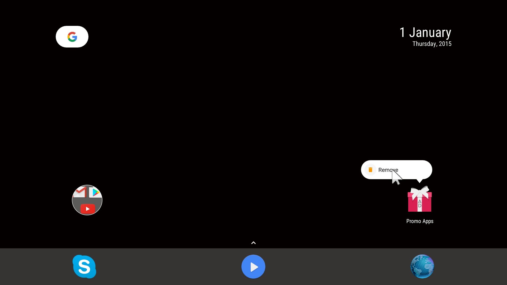

Start ADW Launcher and select the basic theme you like, I used the first on the left.
I do a long mouse press on the Promo icon in the lower right to remove it from the screen and place the shortcut for Kodi here.
To get Kodi on the main screen:
Click the little arrow in the lower center of the screen to bring the apps menu up.
Hold the mouse button while dragging the icon to where you want it on the main screen - easy :)

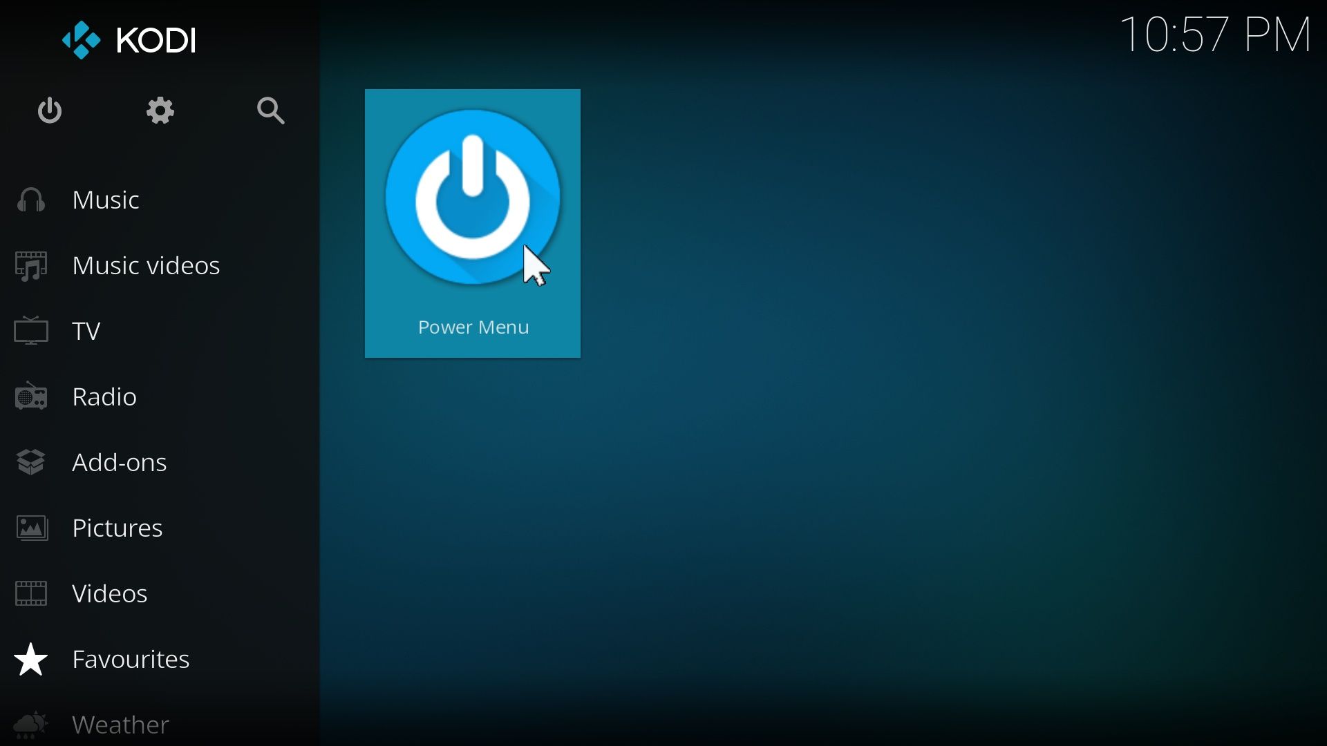

Same story for the Power Menu - I place it between the player and browser button on the lower icon bar.

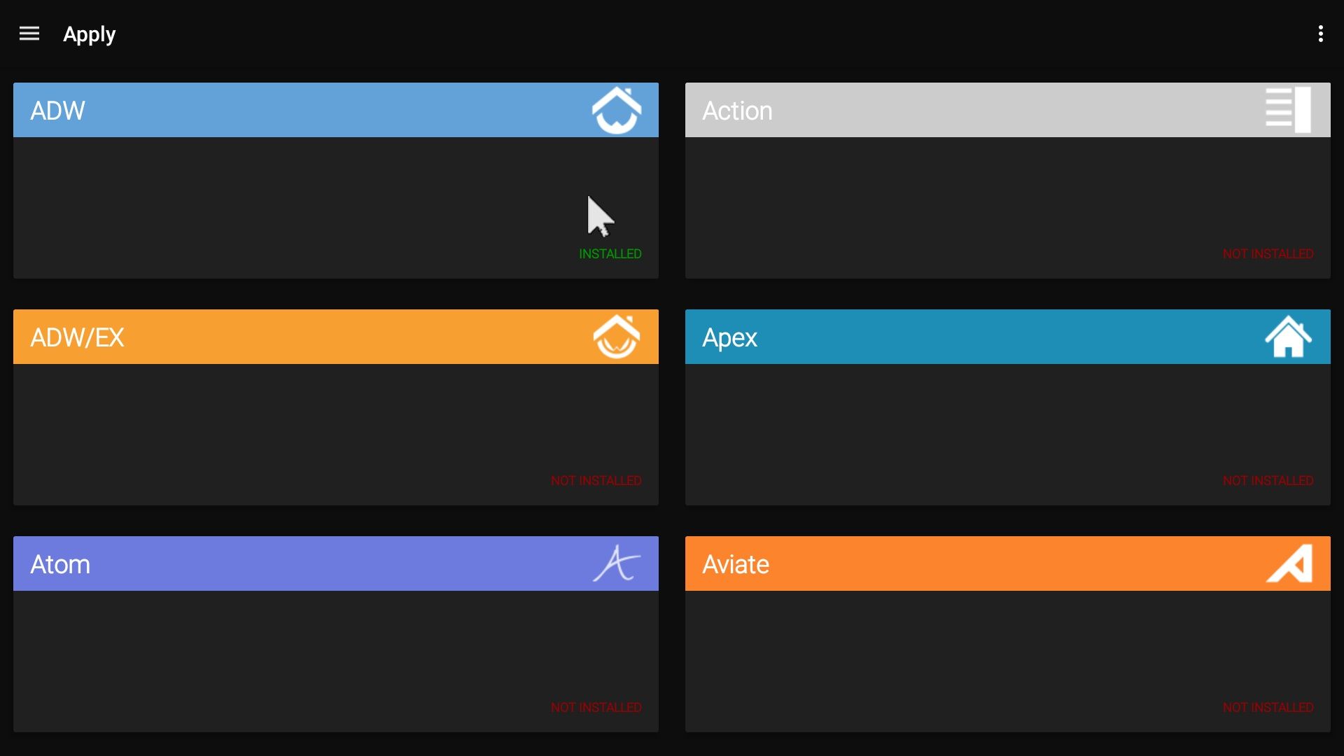

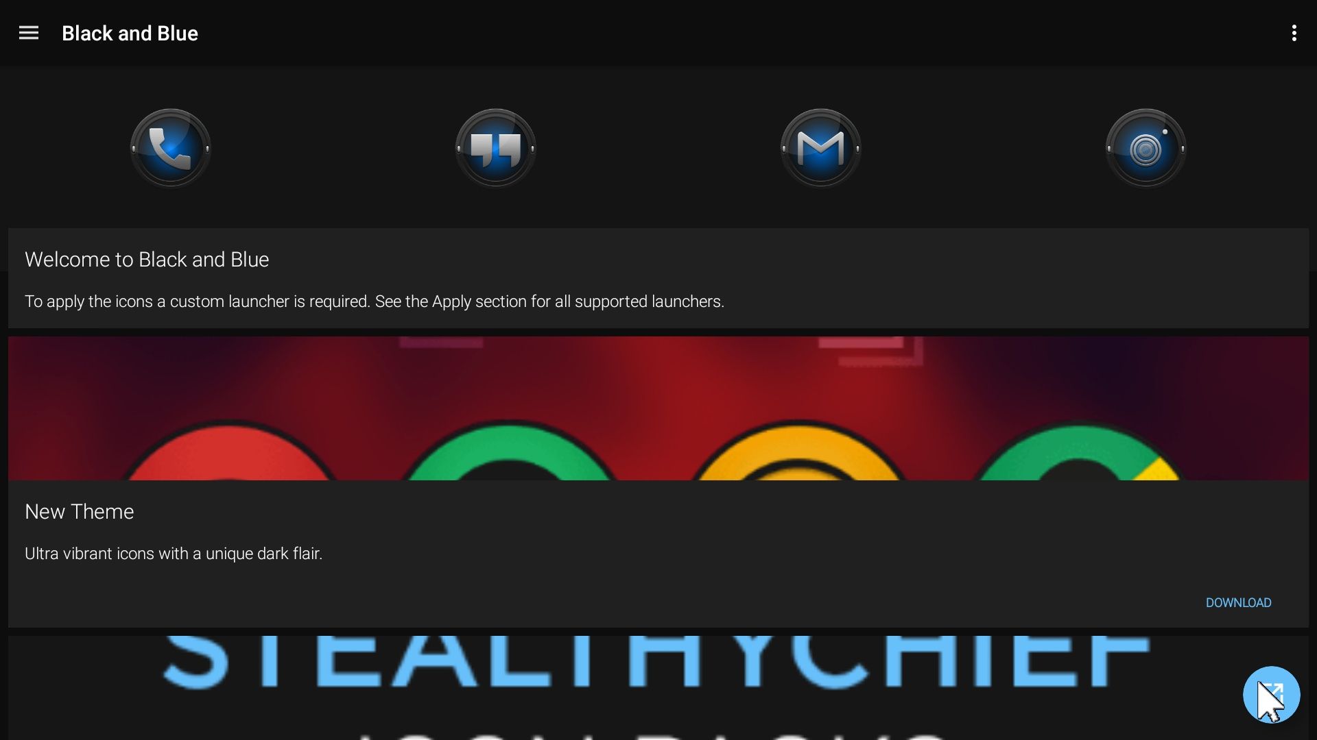

To get it really nice start the Black and Blue Icon pack and select ADW.
Confirm that you want to use these icons and enjoy a nice dark look for your launcher.
Feel free to customize to your liking at a later stage.

Kodi should not need to update endless addons, todays test showed only a few had updates available and two had been discontiued to work, the rest is up to date.
Once all is updated and you made the personal changes in Kodi you like (including testing a stream or two) you can try the favourites menu to restart the box through the power menu.
Now you are set to go and enjoy the new look and feel of your TV box :)

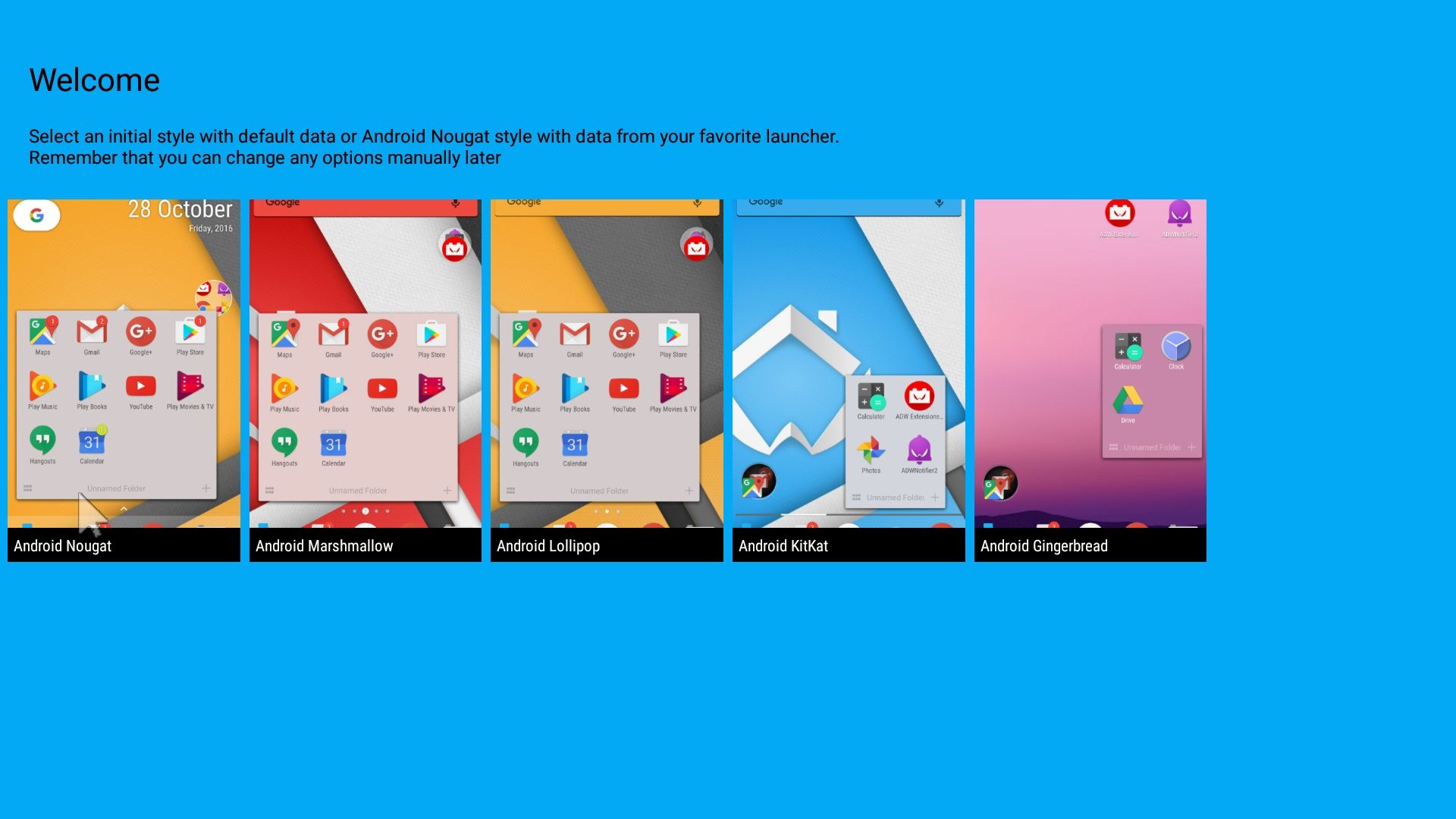

Only real difference I noticed was an updated setup wizard for Google.

Fully rooted with SuperSu installed.
FX File Explorer to replace the default.
The usual fixes for keyboard and so on.
Logo and animation change to the defaults instead of branded ones.
Google keyboard replaced by the much smaller Hacker's keyboard.
AdAway.
Pulsar to replace the stock music player.
VLC to replace the stock video player.
Kodi 17.3
Some other programs I find useful are installed too, some just ready for you to install from the Apps folder on the internal storage.

Let boot until the CPU usage levels out.
Start SuperSu and update the binary - if this fails it means the boot was not complete yet!
Now reboot the box.

Start Kodi and wait so it can check for updates, start your favourite addon and check that it works.
Be aware that at the first start Kodi will be a bit slow to response and might seem to have crashed once or twice.
This is due to updates in the background - please wait until Kodi is responsive again, it can take up to five minutes!

If you install the Advanced Power Menu from the Apps folder you need to start it once to give root permissions.
I included it so you can directly reboot the box instead of just a power down.
