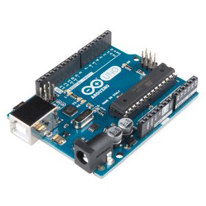

arduino unohttps://www.adafruit.com/product/50https://www.adafruit.com/products/80?gclid=CjwKEAjwns6hBRDTpb_jkbTv1UYSJACBhberXDZgSWJ7KN95BlWx7tvc3ZjtmcyA3Sh_lXhBqeIxOhoCW4Lw_wcB

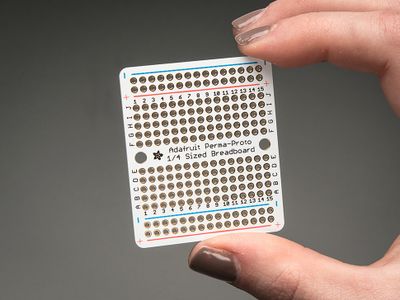

proto board w/ potentiometer http://www.seeedstudio.com/depot/Protoshield-Kit-...

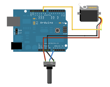

Step 2: Wiring
Wire the servo, arduino, and pot according to the wiring diagram

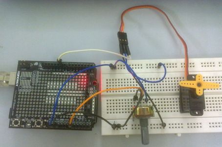

Step 3: Soldering
Connect the pot and wires to the proto board, according to the diagram. When your sure everything is connected properly, begin to solder. I didnd't solder my servo connector yet, but know is the time if you plan on not taking it apart. I just used an old piece of board I recycled.
